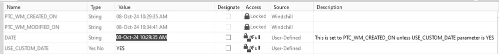

Hello everyone,
I am trying to create a DATE parameter for my startparts, which at the creation of a new part is linked to the parameter PTC_WM_WM_CREATED_ON by a relation, but which can be modified later, if necessary. This, avoiding that users have to modify or remove relations.
With these relations the DATA parameter is editable from the day after creation, but I would like to use something better:
IF PTC_WM_CREATED_ON == PTC_WM_MODIFIED_ON
DATE=PTC_WM_CREATED_ON
ENDIF
I don’t want to be forced to wait a day, but I don’t know if there is another way to do that, using only relations and existing parameters.
Any ideas?
Thank you
Marco
p.s.
I'm using CREO 8.0.9.0 and Windchill 12.0.2.10 and the date format in Windchill is set on dd-mm-yyyy (08-10-2024)
Best answer by pausob
Hmm, I am not sure I would do this in the way you describe.
I suppose the logic would work if your Windchill system was configured to have the date that also includes the time stamp, which is the case in our system.
However, even then there seem to be some flakey issues with the above relation.   For example, a quick test reveals that even though PTC_WM_CREATED_ON == PTC_WM_MODIFIED_ON evaluates to NO, the DATE parameter remains locked and uneditable:
Oh, wait, upon making some more changes and uploading the test file again, the DATE parameter became unlocked:
So this is troubling and anyway, this won't work when Windchill is configured such that PTC_WM_... dates don't include the time stamp.
So I would consider having a YES/NO parameter called USE_CUSTOM_DATE, by default set to NO and the relation be:
IF USE_CUSTOM_DATE == NO
 DATE = PTC_WM_CREATED_ON
ENDIF
ENDIF

Yes you are right, I tested my relation and does not work well. It only works if I check-in the part from the day after creation. Till that, rightly, PTC_WM_CREATED_ON is equal to PTC_WM_MODIFIED_ON. Too unpractical.
Your proposal is a good idea, although I was looking for a more "automatic" method, but it seems not to be manageable only with relations.
