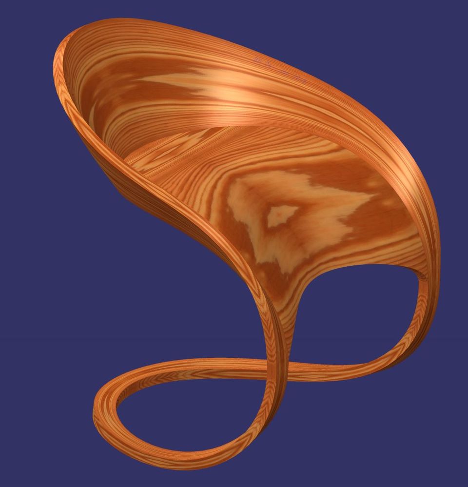

Thanks for the participation in this discussion and I do find some application to this type of surface from the web. I modeled one of the examples, a chair as shown below:
