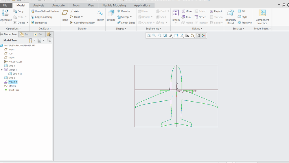

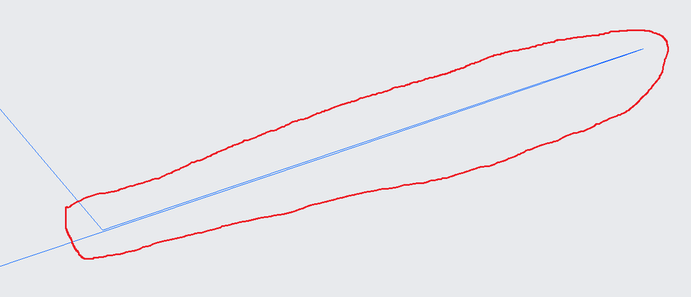

Hi all,
I'm trying to extrude a 2D image of an airplane that I created from complex curves in the Style tool. However, the extrude feature only seems to take sketches. I've tried workarounds with the offset, project, sweep tools, etc, but none have worked. Does anyone know how to extend this image in the normal direction and make a solid object?

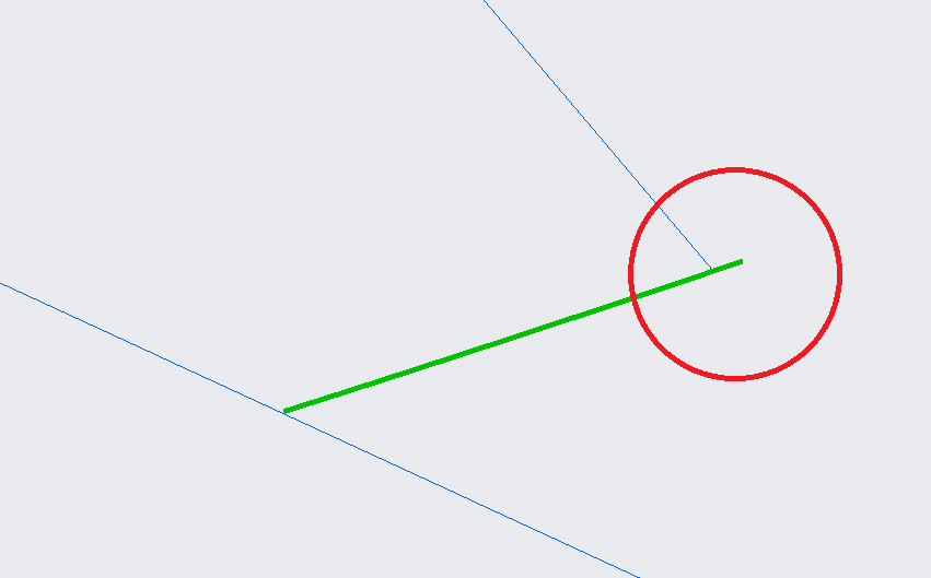

you cannot create solid Extrude feature because of problem hidden in curves. See following pictures.
Zoom your model a lot and you will see unwanted "spike". If you remove it and connect adjacent curve segments correctly then you will be able to create solid Extrude feature.

Hi, I fixed the spike as shown in my attached revision, but it still won't extrude. I can't select the curves when I try to select the Sketch.
You can't extrude it as a solid because, at least, there are multiple closed paths.
You can't select the sketch and curves at the same time. You can either reference a previously made sketch feature or create a new sketch within the extrusion feature and Use Edge to pick existing curves for the sketch entities as well as use any other of the many sketcher tools. Some systems allow picking sub-pieces of curves and do the conversion behind the scenes. Creo requires the user to be explicit in creating or selecting a specific sketch.

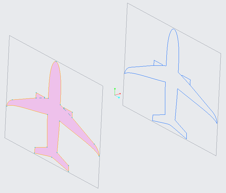

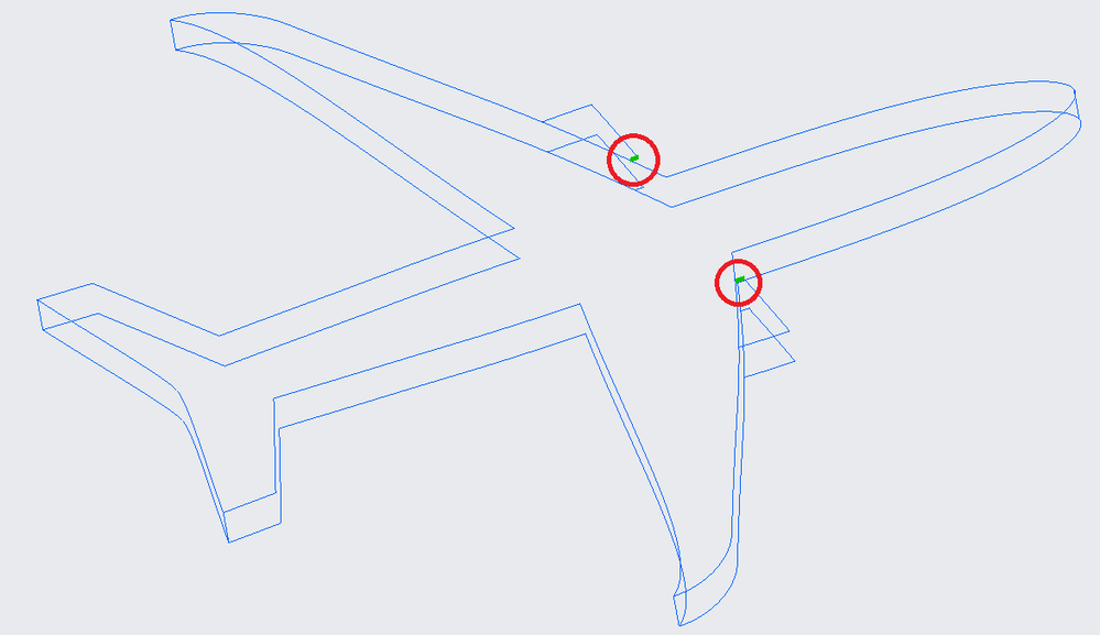

you cannot create solid Extrude feature, if feature section contains "T" connected lines. See red ovals in following picture.

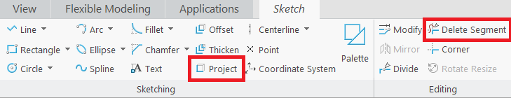

pic01.pngFirstly I created DTM1 datum plane offset from RIGHT plane. Then I created Sketch feature in DTM1.
I used Project command to copy elements of your curves and then Delete Segments command to remove unwanted part of copied curves. This way I get single outline shown on picture. If you select such Sketch feature you can Extrude it without problems.

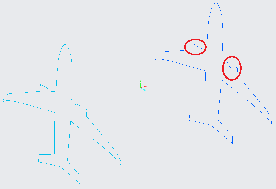

How did you use delete segment to fix it? What parts of the curves did you delete? I got the airplane without the engines to extrude but I tried messing around with delete segment on the engines and it didn't seem to do anything. It still gave me the "Can't have mixture of open and closed sections" message.
I projected all your curves into section of Sketch feature and then deleted segments marked by red lines.

(To:MartinHanak)
Thanks, that did it! Thanks so much for the help
