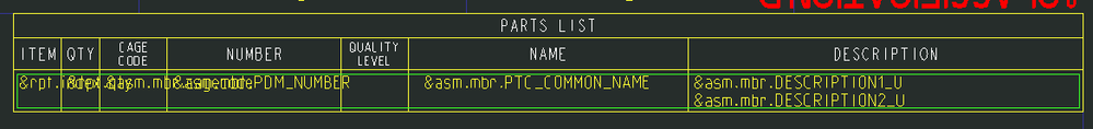

Hi Everyone,
I have a table where I'm showing the parameter values from a family table part.
I would like to have the address pulled from one or more parameters and populate a cell with multiple lines of text in a repeat region like the example in the image below.
Could someone explain how to set this up or point me to a document or URL with more info?
I have been playing with the repeat regions and filters and have had no luck getting the address cell to populate correctly.   I'm trying to used a separate parameter for each line of text.
Thanks for any help you can provide!

If each line of text in that cell is a separate parameter, just create a multiline cell entry.
In the Properties box, use:
&asm.mbr.company_name
&asm.mbr.company.address
&asm.mbr.company.city
&asm.mbr.company_zip
Can you add the multiple lines in the address cell like I did with the Description?
