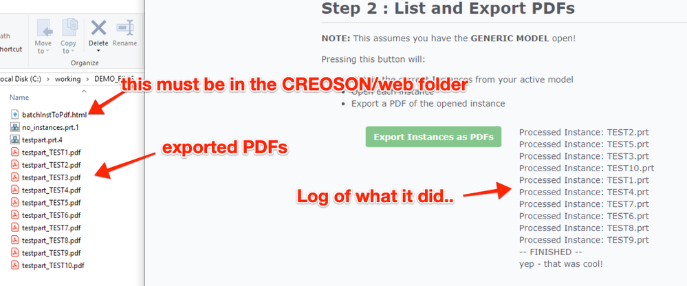

I am always up for a little challenge to show off how COOL CREOSON is... 😉
Attached is a ZIP file that contains the HTML file that does what you are looking for in your example as a baseline - it also has a couple of test Creo files (Creo 4).
There are some comments in the HTML code to try to explain a few things.  It should be easy to follow - the main code is near the bottom of the HTML Source.
It does the following:
  • Assumes your current active model is the generic
  • checks for any instances in that active model
  • processes each instance into a PDF file in your working directory with a custom name (<generic>_<inst>.<ext>)
You just need to download the HTML file and put it in your CREOSON/web directory - then open it in your web browser.  (assuming you have CREOSON running)
The link after you put the file in the CREOSON/web directory should be : http://localhost:9056/batchInstToPdf.html
This code could be used as a baseline for doing other things quite easily.  You just have to be careful about following the workflow that it does currently and try to slip in other cool stuff you want to do - there is a bit of a pattern to coding these and putting it together.
Just put the Creo files in a separate directory, make that your working directory and you should get a nice example after you load the testpart.prt into Creo's session (again they are Creo 4 files - but you can use Creo 5 or 6 no problem).  Here is what it looks like when finished:

hi and thanks for your help
@MartinHanak
I thought that it was possible to write a program that reads the trail.txt file, replaces the name of the instances and PDF-filename with the new/next instance and filename and then saves it. This would create one trail-file per saveToPdf-operation. But it doesn't seem to be possible to play more than one trailFile at once in Creo...
So the program has to create one big trail-file that includes all of the SaveToPDF-operations ? Is there already a tool availibe that creates this code or did you write the program yourself ?
@DavidBigelow
I launched your program and it worked. It created one PDF-File per instance, but in the PDF-Files only contain screenshots of the different parts. Is it also possible to export a drawing of every instance of the familyTable ?
I have created one drawing for the generic part. It has to be replaced with every instance and then it should be saved as PDF. That would be awesome.
Thanks...

Awesome ... glad it worked like you expected. And yes, a server based dynamic model is just one (1) use case for CREOSON.
BTW... the relations question you asked about can also be handled by CREOSON. THAT situation is where mapkeys and trail files fail to deliver due to no interactive logic handling or operations.
A simple ... “file : relations_get” call will get the model relations and then your just need a simple check for the model name within the relations text to determine if it exists or not.
As a bonus... you can modify your relations and sent them back to the model using “file : relations_set”.
CREOSON has a TON of functionally that can be structured into whatever logic process you want.
Nitro-CELL uses the same heart of CREOSON so you can do the same operations from Excel just as easily (no coding).
Dave
