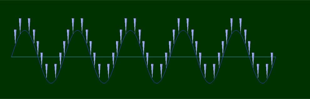

If I follow his example pretty closely (minor tweak on one of the axis references), the axes flip with the sign change and I get the following:
If instead of patterning the points in a direction (as he does) but instead pattern the points along the curve, nad pattern each piece individually, none of my axes flip, BUT my sketch no longer patterns along the curve, but on/around itself, even though all the axes and datum plane has properly patterned along the curve...

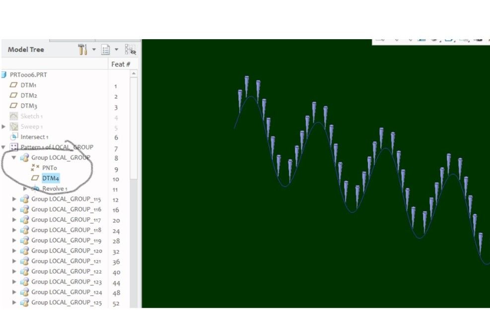

I attached here a neutral format to allow you to look at the 3D model. The key feature is the datum plane created for revolve section plane. This datum must be created using the point(through) and its parametric curve (normal). See the pic below:
Let me know if there is anything else needed. Good luck.

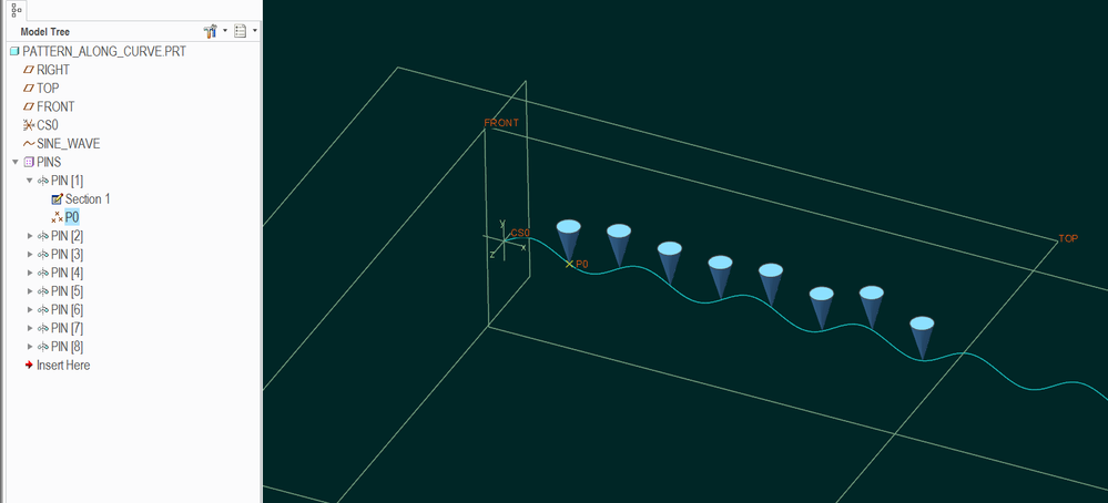

Anyway, in your case, you only want the spacing along the curve to be the pattern driver.  You have constructed your SINE_WAVE using the curve from equation:Patterning feature along a datum curve made by equation-from-curvePatterning feature along a datum curve made by equation-from-curve
Now place a datum point P0 on this curve (read on for explanation of why this point shows up as a sub-feature under the PIN feature in the above example).
Then the next thing would be to build the PIN feature (revolve).  It is important to be careful and use the P0 datum point as the only entity referenced by the pin's revolve section.  Also note that the placement plane for the pin's revolve section is FRONT, and the TOP plane is the section's orientation plane.  The pin's revolve section has the axis of revolution that is constrained to be vertical and coincident to the referenced point P0.
After the pin feature is constructed and exists in the model tree, then it can be made to "absorb" the datum point P0.  That's done by dragging the P0 feature onto the PIN feature in the model tree.   Doing this makes the point P0 an internal datum of the feature PIN, and the dimension of this point (and therefore the pin's tip) is available for use as a basis of patterning the pins.
