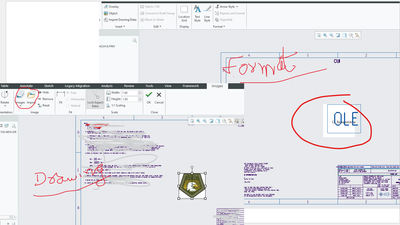

I In .drawing the way to bring an image is clean and nice resolution. WHY in .format, it has different setting for Layout? No Images option!
What is the best way to bring image in format the same way as in drawing?

to get an explanation you have to contact PTC Support.
My suggestion ... use drawing template instead of drawing format.

This is easy! It should be incorporated in to formats very easily. Will keep it open for PTC's thought...Still will ask ptc tech.
Create a symbol of the image. e.g Company Logo.
Insert the symbol. One can insert symbol both in Format and in Template and scale them too.
