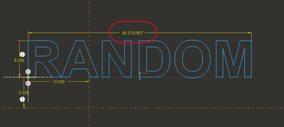

I am about to create a parametric model with the geometry relying on text fields that change for different parts of a family. For this I need to either know the dimensions of a text field (height and width) or have the possibility to get points (for changing text fields) on the boarder/edge of the text field. Is there a way to do this? As of what I currently see there is only a way to set/get either the height OR the width (which is the line which the text field is aligned to).
The blue circled area on the screenshot shows an example text field where I want to grab a point or a measurement on the outer line surrounding the text (The text is aligned to a vertical line on the left.).

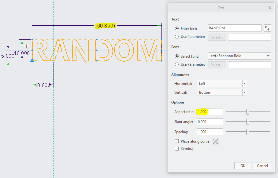

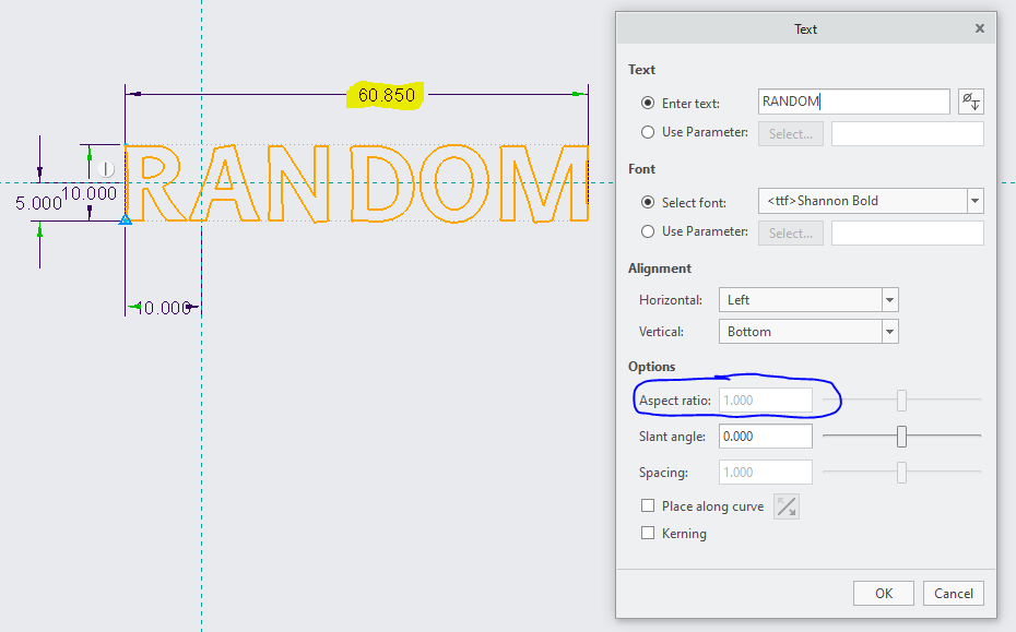

  2. The width dimension you're creating is actually controlling the aspect ratio.  You can see this by toggling the dimension from strong to reference and then looking at the text properties.

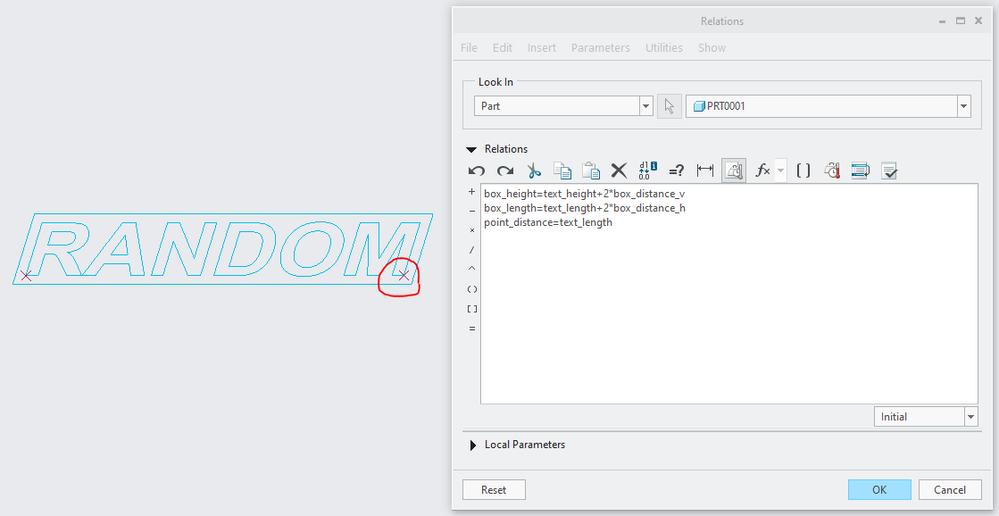

if you want measure the distance between the end of text and box, then you can add geometrical point into Sketch 1 feature.
See modified model.

it does because of existing relations. Please edit definition of Sketch 1 feature, modify text and regenerate the model.

if you open model modified by me you will see that position of the point is driven by dimension ... and value of this dimension is driven by relation. You can change the text inside Sketch 1 feature -OR- relate it to string parameter value >>> it works (after model regeneration).
