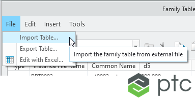

@JGPrice wrote:
This family table was created using the excel interface.
Do you mean that an xls file was created from scratch then imported in Creo with the command File > Import Table... :
Or can you confirm you created that table with Edit with Excel in the first place?

You confirm the family table was created from Excel from scratch and this introduced some rounding errors. I'm sorry to share that this is unsurprising and this reinforces the practice to refrain from using Excel when it comes to tabulated files.
It is well known in the industry that Excel introduces meta data behind your back. Some tricks to iron these out consists in:
  • saving to .csv instead of .xlsx
  • make sure the encoding is supported. In our instance the ptd file is encoded with UTF-8-BOM
In your instance, I recommend to start the family table with Creo then either:
  • export to ptd and then use Excel if you prefer or rather use something like Notepad whose footprint more neutral or
  • File > Edit with Excel. This will fire Excel and keep Creo in the background the main idea being to keep Creo in the loop at all time
