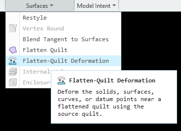

I'd say you should look into the "Flatten Quilt / Deformation" tools
Basically you will: 1) Flatten your curved wing surface to obtain a flat quilt.  2) deform the (flat) textured surface to the shape of the curved wing using the (reverse) deformation from step 1..

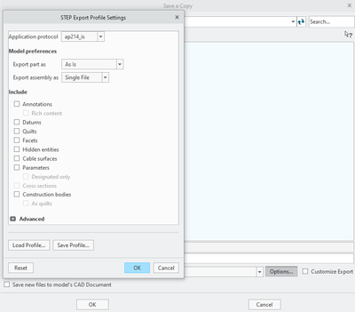

Thank You for Helping me out, I managed to get my intended result, but now the problem is the flatten quilt feature which was formed earlier. I can only able to hide it,  when exporting as an STEP or IGES file the flat quilt is also there, I want to suspend the Flat quilt without suspended other parts like the extruded features and flat-quilt deformation.
pausob
(To:AH_10155331)
You will have to check your export settings.  For example, when doing the save-as, click on the "Options" button and then make sure you are not exporting hidden or construction entities.
Thank you, I  finally got what I wanted to do

In my opinion, the use of "Flatten Quilt / Deformation" has an impact on your design intent.
The fish's scales do not deform according to its body structure (NACA), but rather change the orientation.
