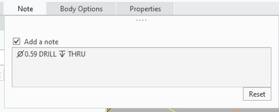

When we originally did our .Hol files over a decade ago we decided it wasn't possible to call out both FREE and CLOSE in the callout formats.  The Hole note on the drawing could only be shown as a Free(what we set it as).
Is that still the case?  When i add in CLOSE to the matrix/table it still just only gives me a Free callout and not the Close when Close is the value set in the model
Thanks!
DEFAULT_CALLOUT_FORMAT_DATA
HOLE_TYPE   THREAD   DRILLED_DEPTH   THREAD_DEPTH    CSINK   CBORE   EXIT_CSINK   CALLOUT_FORMAT
CLEARANCE   NO       THRU_ALL        NA              NO      NO      NO           &HOLE_INSTANCE_COUNT&HOLE_INSTANCE_X_SYMBOL <CTRL-a>n<CTRL-b>&FREE_DEC[.2] DRILL <CTRL-A>x<CTRL-B> &DRILL_DEPTH
CLEARANCE   NO       THRU_ALL        NA              NO      NO      NO           &HOLE_INSTANCE_COUNT&HOLE_INSTANCE_X_SYMBOL <CTRL-a>n<CTRL-b>&CLOSE_DEC[.2] DRILL <CTRL-A>x<CTRL-B> &DRILL_DEPTH

Going through the PTC Help some more...
i changed Free Dec/Close Dec/Etc to report &DIAMETER instead of &FREE_DEC.  Working through some other stuff, but i think i got a handle on some of this after not looking at it for a decade
CLEARANCE   NO       THRU_ALL        NA              NO      NO      NO           &HOLE_INSTANCE_COUNT&HOLE_INSTANCE_X_SYMBOL <CTRL-a>n<CTRL-b>&DIAMETER[.2] DRILL <CTRL-A>x<CTRL-B> &DRILL_DEPTH

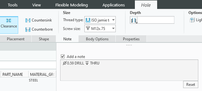

I created a custom NPT file.  I have it loaded into the directory that my other .HOL files are.  All of the straight drill .hol files are being read correctly, but the NPT .HOL file isn't being read.  I've renamed it to something different (thread series thread name) and I've also copied the same name as the commonfiles NPT file.  Neither is working.
Any ideas?
Any ideas?
there is probably an error in your file. Please upload it.
Martin Hanák
PTC said there's a bug in the system
trail file contains following information (I renamed NPT-JAMIE.hol to NPT_REFINED.hol]
!%CILoading Hole Charts ...
!%CWFormat error in fastener input file : E:\PTC\Creo10_060\Creo 10.0.6.0\Common Files\text\hole\NPT_REFINED.hol at line no: 38
This means that Creo does not accept bottom part of .hol file, i.e. CALLOUT FORMAT definition table.
I apologize that I do not have time to resolve your problem.
Martin Hanák
Thank you so much for that.  The error was not having
above the specific combination note syntaxes.
appreciate it!
