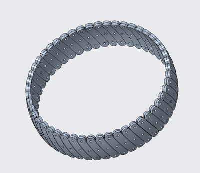

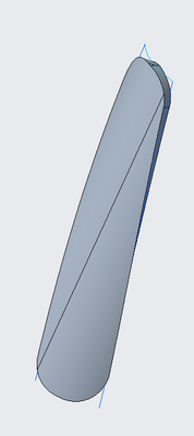

I am trying to replicate a curved scissor mechanism from an old purse (image named open and closed below), I am having some trouble connecting the assembly particularly the translation for the curved parts (image named translation below) , it is working fine with the non-curved version as I selected the bottom and top surfaces respectively. With the curved versions even when I attempt to define unique planes for the translation it does not seem to work, I assume it is due to a problem with the geometry I have defined.
I would really appreciate it if the error that I have made can be pointed out, I am attaching the files below.

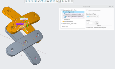

Fearing I might have not described the issue succinctly, I will summarise it here: I am unable to make a pin connection for the curved part on the end holes. Picture attached. I would appreciate any and all feedback.

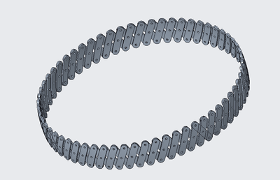

As an update, I was able to make the assembly using a mixture of other constraints however they are not reliable. Some parts seem to overlap when I reopen the file and this was not the case when I defined the assembly.

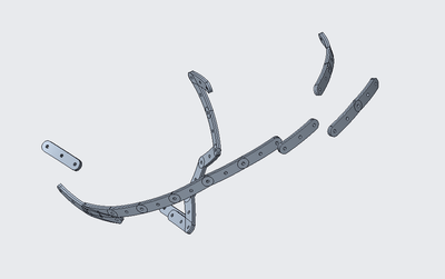

Also when I view the sub-assemblies they no longer seem to hold their shape when the file is re-opened in a new session. (they should look like a section of the assembly above).
The assembly does seem to work as I intended to however I think the method I applied is not reliable, I would appreciate methods to improve this. Files attached below.
As an addition, I defined each connection manually even though they were the same connections, I am not sure how I could have used creo to automate this, any and all suggestions for that are most welcome.

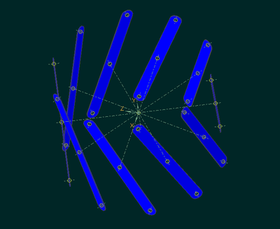

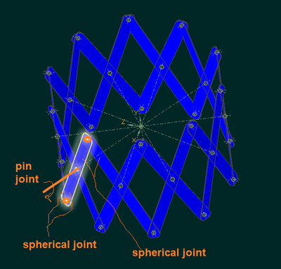

But I had a quick go at this, and I defined the kinematic structure in this way:
Each link placed by a pin joint.

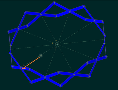

then the connecting links that complete the "x" are assembled, each with 2 additional spherical connections that link 2 of the previously laid out links above:
Note after this is all done, the whole assembly is not moveable.
But modifying the radial distance effectively closes or opens the "scissors":
So this construction requires regeneration to update, but you could build on this idea and devise a 1-input mechanism that makes it possible to "drag" the mechanism around.

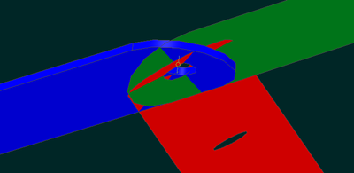

However, I do suspect the actual device has slop in the "pin joints" which allows the extra degree of twist required (or the links themselves twist a little) - because the angle of the "pin" axis between the adjacent links changes as this device opens and closes - here it is illustrated by drawing the surfaces of the next link in the open position (green) vs closed position (red):
(this is done with straight links, so not sure whether using curved links would solve this)

Thank you very much, it definitely gave me a lot more think about and made me consider new approaches.
For posterity, I figured out how to do the pin constraint for the curved features using a datum point, which works very well.
