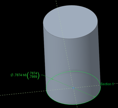

I have a 20mm shaft for a bearing; recommended shaft fit is h6. For a 20mm dia, h6 is:
+0
-13.
In inches, that is + 0, -0.0005". So the drawing should show 0.7874/0.7869 if I show limits.
I set the diameter to nominal, 0.7874. I apply an h6 tolerance.
If is specify plus/minus, the dimension appears at 0.7874 + 0.0000 / -0.0005 (perfect!)
If I show 'limits', it changes to the nominal 0.7871 and then applies the -.0005 to that, so 0.7866. This is wrong.
What am I doing wrong?

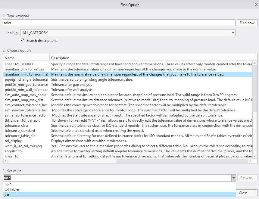

Hi, I think you can get the dimension to behave the way you want if you set the config.pro option maintain_limit_tol_nominal to yes:
(seems the same outcome if you set maintain_limit_tol_nominal option to the value "tol_tables")
