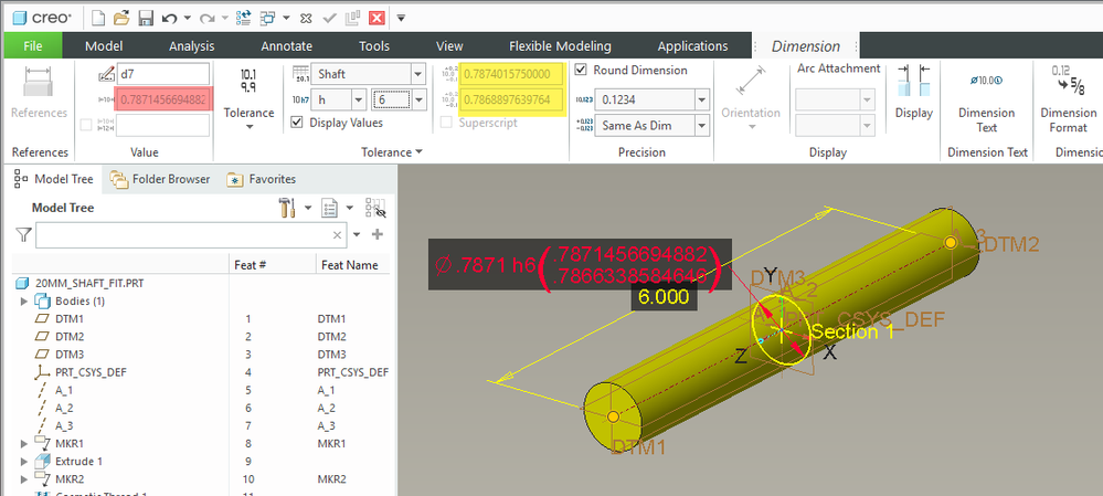

Longtime Creo/WF/ProE user (2000i2). Having an issue with fit tolerances using the tables. I've configured both the part and drawing to use the tables.
Problem example:
I have a 20mm shaft for a bearing; recommended shaft fit is h6. For a 20mm dia, h6 is:
+0
-13.
In inches, that is + 0, -0.0005". So the drawing should show 0.7874/0.7869 if I show limits.

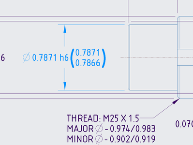

I set the diameter to nominal, 0.7874. I apply an h6 tolerance.
If is specify plus/minus, the dimension appears at 0.7874 + 0.0000 / -0.0005 (perfect!)
If I show 'limits', it changes to the nominal 0.7871 and then applies the -.0005 to that, so 0.7866. This is wrong.
What am I doing wrong?
TIA
I was able to replicate the issue in Creo 7 in both SI and imperial units models. Creo is shifting the nominal value of the dimension but the limits from the shaft table are calculated accurately, they are just not displayed/stored with the dimension in the model. The limits shown in yellow are accurate from the table but the nominal in red is shifted from the staring value. If no one provides a resolution here in the near future, you should open a tech support case.

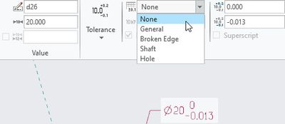

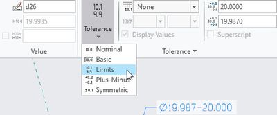

To fix the issue, add one step: set tol tables to 'no' and only then switch to 'limits'
