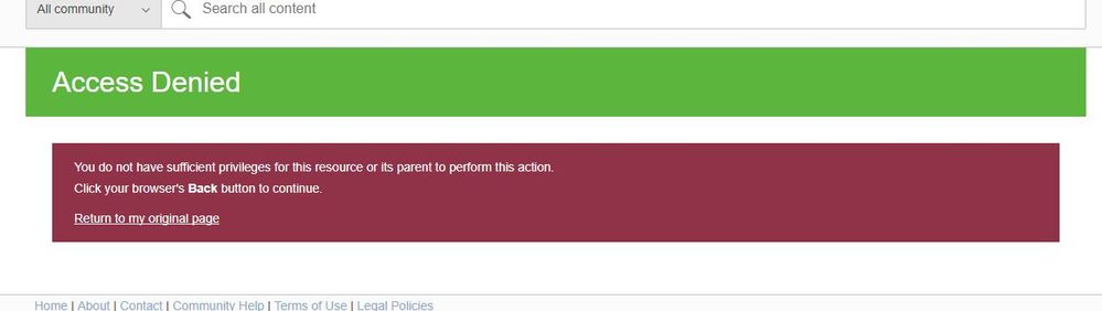

This is odd, when I follow the link to Bringing Large Assemblies Down to Size I get an error that I do not have privilege to see the page. I am on active maintenance. Does anyone have an idea why I am having this issue?

The link you posted works for me. The other links in this topic don't work for me and generate the same error you got.
Try the link in your post.
Adobe flash issue, I was able to get it working, thanks for the double check.
The document may be only allowed for those who attended the convention that presentation was made for. It links to
 community.ptc.com/t5/PTC-Live-Global-2015/Bringing-Large-Assemblies-Down-to-Size/ta-p/444618
