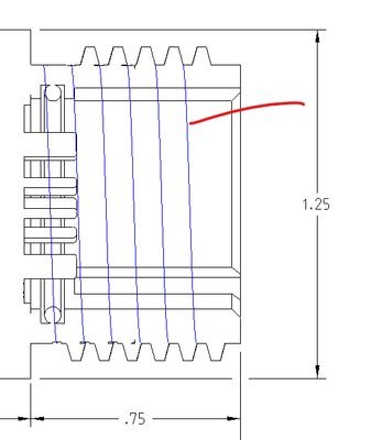

Can someone explain how to hide a sweep profile curve in the model and drawing? Similar topics discussed setting the config.pro option 'mesh_spline_surface' to 'no'. I have tried this and it doesn't seem to work for me. Thank you.

For some reason this did not work for my newly created layer. So, I tried this with an existing default layer 'DTM_CURVE' and it worked. Thank you.

You should put it on a layer in the model and hide the layer in the drawing.
wbottis
(To:kdirth)
I can create a new layer, but then how do I select the curve to add to the layer? Thank you.
kdirth
(To:wbottis)
RMB on layer, select Layer Properties, and select curve on screen or in tree.
wbottis
(To:kdirth)
Patriot_1776
(To:wbottis)
Create Rules-Based layers, and hide them as needed, then SAVE layer status before you save the dwg.
