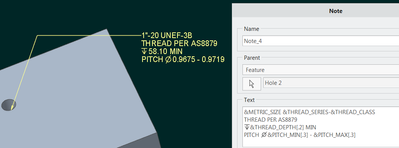

When placing a 1"-20 TPI hole in a model set to metric units the hole note is using metric values. I want to display inch values in the note. Does anyone have idea how to set this to display the inch values? Creo 7.07. I have also included the custom hole table used to create the feature for reference.

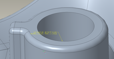

This is a hole created using the same feature and hole table in another model that is also in metric units and it displays inches.

You mention that the hole in the 2nd image was made in the same way as the hole in the 1st image, yet the note is different (looks like the standard Creo hole note)  So to clarify, you want the result shown in the 2nd image (1-20 instead of 25.400-20) ?

Yes, the objective is to have the note look like the second image with inch units for the thread (1"-20").
Creo does not have standard holes for EF series threads out of the box AFAIK so that is why the hole table is in use. I believe that the hole was created the same way in both models and both reference the EF series hole table.

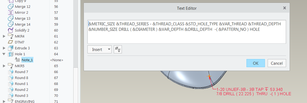

It looks like the hole notes may be referencing different tokens and/or parameters.  Double check the syntax in each note.
tbraxton
(To:TomU)
They are indeed different. I am not proficient with implementation of hole tables so is there a document that details how this would be controlled using the table?

One thing I'm noticing from your notes is that the pitch Ø of the thread (or its minimum and maximum?) is being shown by re-purposing the parameters CLEAR_DR_MED and MED_DEC - which are meant to be the clearance drill names (string parameter) and size (number parameter) for "medium clearance" holes.  This explains why the 0.9675 remains unchanged in the metric model, but 0.9719 gets converted to 24.686

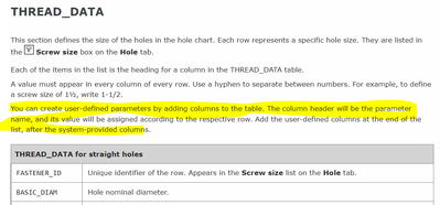

There is no need for this "hack" as one can add and call out a custom hole parameter(s) by appending column(s) in the custom .hol chart as explained in the help file:

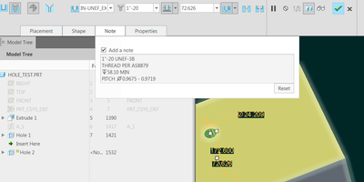

(it also ignores my 3 decimal places format specification - that's disappointing; there is definitely some strange things going on with hole notes behind the scenes, maybe they got fixed after Creo4...)
Anyway, I attach the custom hole table (used to make the hole shown in the screenshot above)
