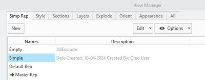

Want to submit an enchancement to add "Last Saved Date" and "Last Saved By" columns to the View Manager for the Simplified Reps Tab.
They will help engineers see who and when Simplified Reps were last saved and not have to put that info in the Simplified Rep Name.
2 REPLIES 2
While not automatic, that information can be created and displayed today using Description.
Edit the description to enter the data.
Use the Options tab to show descriptions.
View manager reps are internal to the file, they would not have created or modified information like an external file would.
