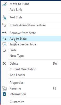

"Add to state" is under Annotate tab, Manage annotations group, is it inactive or not available?

Thanks for investigating this!  I added "Add to State" to the right-click menu using "customize"...
