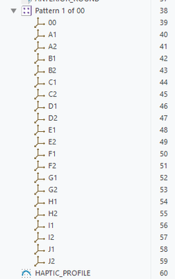

How can I populate table using dimensions from a pattern table? All Csys are in a pattern table. I am using Creo 7.0.5.0

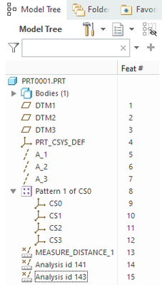

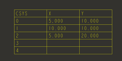

Enclosed is a Creo 7 part and drawing for reference. This is not the only way to do this, but it is the most robust IMO for most scenarios. There is a pattern of csys features in the model.  Note that I have created a measure analysis feature to get the offset values relative to the reference csys you want to measure from, this will account for the negative values if there are any and avoid the "incorrectly" signed (+/-) values associated with pattern parameter values. I only filled the table for the first 3 csys features.
Note the table display:
Syntax required to use the measure value parameter from the analysis feature FID_XXX is the feature ID and is unique:

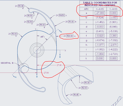

I would like to create a table on a dwg that will populate with the dimensions of the coordinates show in the attached image. All the coordinates are center points for arcs that define a curve used as a profile for the part.

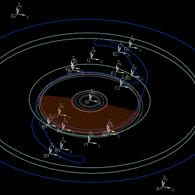

The csys were created in part mode. The first csys was created offset from an existing csys. That csys was patterned giving csys  A-J. It is the csys label and x, y dims I would like to add to a table on the dwg to depict the center of the arcs of the inside blue profile. This model is the generic of a family table. The profile will not change on any of the instances. Other features change not affecting the profile. Sorry if I am making this more complicated than it should be.
 In the current dwg, an attempt was made to show a table with these dims. As you can see, the dims are incorrect. 2x R30.00, per the table, has 2 arcs at the same location which is not true. They both lie on Y 0 but X is -27.00 and 27.00. The same is true for other arc centers. I would like to generate a table showing true values.

This will work. Thank you.

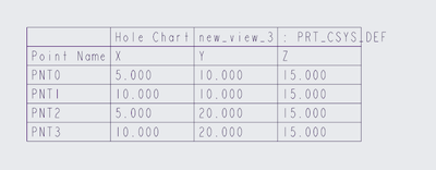

I think there's a much easier solution. Add a point to one of the coordinate systems and make a reference pattern. Then add a Hole Table on the drawing. This will list the coordinates of all the points, no manual work needed. See attached Creo 7 file.
EDIT: Note that you can edit the hole chart, and you don't need to list the Z dimension:
