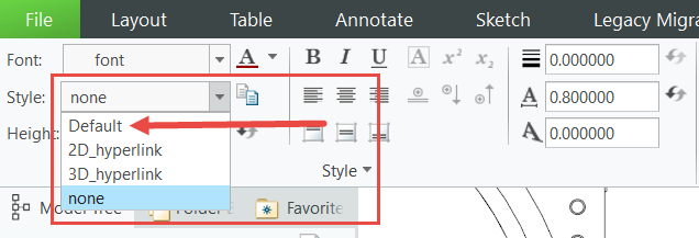

Community,
When adding text, for example, to a parts table, after I double-click the cell where I want to enter the text, the Format tab activates, and the Style default is "none" (highlighted in blue).  I want the Style default to be "Default" (see red arrow below).  How can I change the Style default from "none" to "Default"?  Thanks in advance.

ThoRig
(To:kdirth)
I know how to change the style, but there appears to be no relation or link to the red arrow I posted.  No matter how many combinations I try, it will not work.  Setting the config option text height will not work either.  The default text height is 0.15625 (5/32), and I changed it to 0.125.  This works for adding notes to the drawing, as everything will be 0.125.  However, adding text to a created table, it will default to 0.15625 under "none", and then I have to select Default to change it to 0.125.

Excellent!  This changed the entire table to the detail options text height of 0.125, which is the default.
