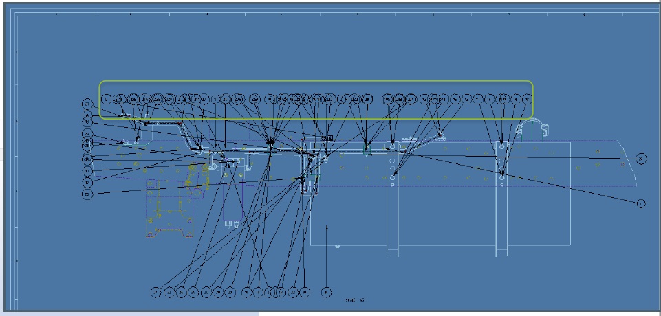

When we are going to place repeat region bom balloons, it is getting overlapp so we need to move it manually.
So is there any option or method to avoid this.
FYI. snap is given as below.

I tend to place balloons by component so that only a few are dealt with at one time.
March 16, 2017
This is too common issue of Pro/E and Creo Parametric. I also recommend creating the balloons by component. Don't even bother with the Cleanup BOM Balloons functionality.
