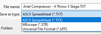

     Thanks for your post, and the suggestion.  Here are the options when I'm exporting from ME'scope.  Creo doesn't recognize the .STR file type, so my only two other options are .UFF and ASCII.  I was hoping that ASCII would be similar to a Parasolid.
I need to give a shout out to Patriot_1776.  He suggested starting a part in Creo and saving it as an ASCII file, then pasting in the values from the ME'scope file.  This might work, but I haven't had a chance to try it yet.  I may try that today, if I get time.
