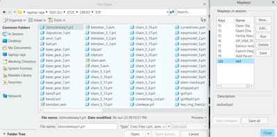

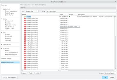

I have created a mapkey to open a .prt and import to .stp(refer config2.pro). I succeed on that one. But I also have several .prts to convert to .stp. so I copy the mapkey, pasted various instances and replaced the .prt names(config3). but it didnt work.
later i found some tools from here Repeatable Mapkey Generator – 4K Side and that one works.
how did that work mine gives error?

LOL. I figured it out. The problem is, in order to loop/mapkey(continued) the there should be a ;\ I used ; only.
; only used for the end of the mapkey. Now I can loop.
