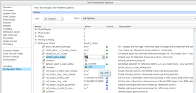

Have you tried editing the config.pro option for interfaces? There are a lot of settings here, some specifically are - "default_comp_geom_scope"s, "default_geom_scope". Some of these may give you the control you are looking for:

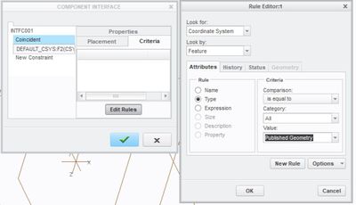

If this doesn't give you the control you want, another thing you can do is add filters/rules to the component interface definition - so that the interface only allows you to select from publish geoms. If you want it to be interface-to-interface, you could edit these filters to be more advanced as well.
