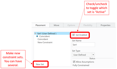

The key is the parameter PTC_CONSTRAINT_SET which controls which constraint is "active" for any two items assembled together. This is an often forgotten parameter which is not typically displayed. The value of this parameter is a string containing the constraint set name.

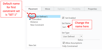

To explain, each constraint set has a name. You can see it on the Placement Tab during the operation to assemble a new component. You can change the name by typing a new one into the Set Name field as shown below.
You can create more than one constraint set if you wish. You can name each differently and determine which one is "active" by checking/unchecking the Set Enabled option. See below for commands to add new sets and enable/disable:

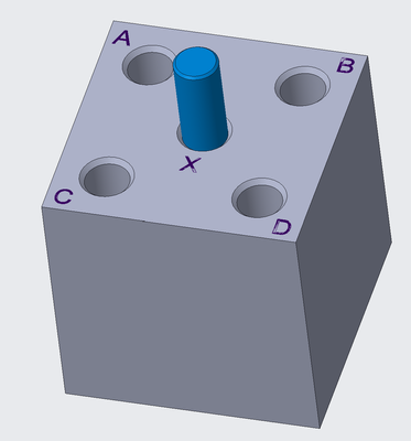

For my example, I am using the model shown below as my "static.asm". The default location for the pin in the cube will be location "X". I'm going to create separate constraints for the pin in all the other locations, too. Here's the model:
After creating and naming 5 sets of constraints (one for each pin location A, B, C, D, and X), the constraint screen looks like this:

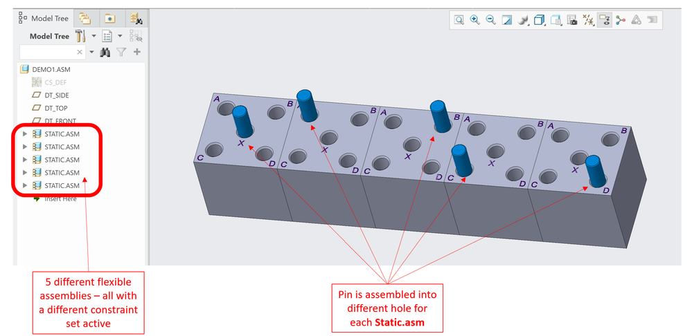

So now you have ONE assembly with 5 potential positions for the pin. You can now place this assembly within multiple other assemblies - and vary the pin position using Flexibility. There's a trick to it - but once you see it, it's very easy. There are a couple of ways to achieve the same result. I'm detailing just one method here.

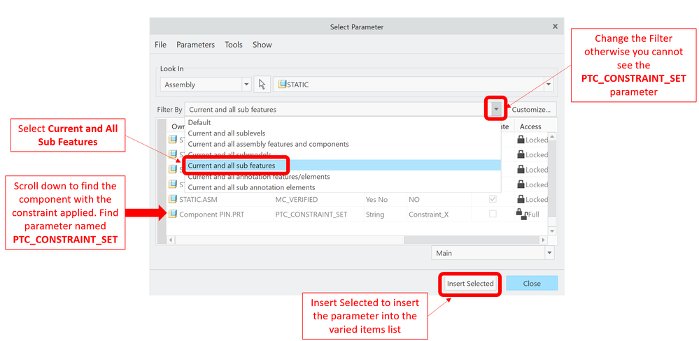

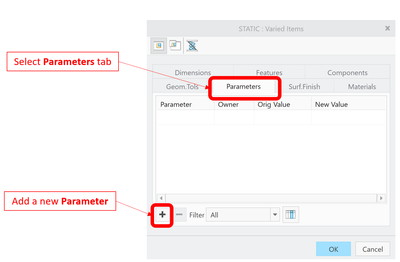

Assemble your static.asm into a higher assembly as you normally would. Right-click the model in the model tree and select Make Flexible. From the Varied Items screen, select the Parameters tab. Add a new parameter using the "+" as shown below:
Here's where the trick comes in - to see PTC_CONSTRAINT_SET, you must change the parameter filter from Default to Current and Sub Features as shown below:
Find PTC_Constraint_Set and add it to the varied items list using the Insert Selected button. Change the New Value field to a different constraint name. It helps if you've named your constraints something memorable so they're easier to understand at this step.

You can repeat this process as many times as you wish. For my example, I assembled 5 static.asm models and changed the constraint active for each. Here's the final result:

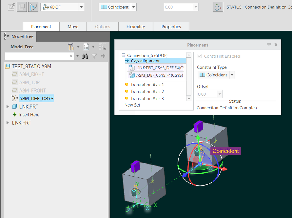

I think your choice of words "STATIC" is a little bit confusing, because I am assuming that you are trying to design a certain "flexibility".  I suppose your design intent is that sub-components A/B should be "together", but their relative placement depends on the context.  If that's the case, you could try building your STATIC.ASM model so that B is constrained with a general 6-DOF connection:
Definition of B component in the TEST_STATIC.ASM- general placement (not yet "finalized")Definition of B component in the TEST_STATIC.ASM- general placement (not yet "finalized")
This scheme allows component B to be "finalized" with respect to the parent assembly by specifying 2 general connections.  Also note that each instance of TEST_STATIC can be placed differently :
"Finalizing" the configuration of an instance of "TEST_STATIC.ASM""Finalizing" the configuration of an instance of "TEST_STATIC.ASM"

I would suggest adding Predefined Flexibility to static.asm.  This will allow you to vary the position as you add it to parent assembly.
  • In static.asm, select File/Prepare/Model Properties
  • Select change for Flexible in the Tools section
  • Follow @BrianMartin steps to select items to vary
    • You will not need to select a position
  • When adding static.asm to an assembly you will be asked if you would like to use the pre-defined Flexibility.
    • Select Yes
  • Select the Parameters tab and enter the desired constraint set name.
  • Constrain static.asm as usual.
