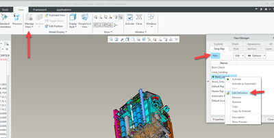

How to open this editor
Inho-_-
I want to know how to open this editor
it is about Automatic Representations ( ver. CREO 9.0 )
StephenW
(To:Inho-_-)
go to the view tab, select the view manager, select Simp Rep from the pop up. Then you will either create a new Rep or RMB edit definition on an existing Rep
