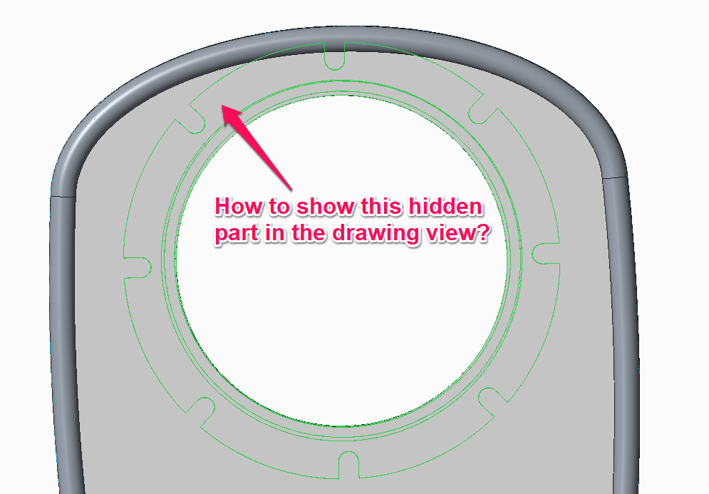

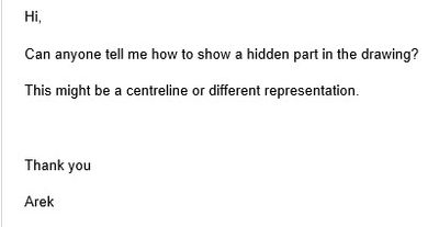

Can anyone tell me how to show a hidden part in the drawing?
This might be a centreline or different representation.
The most important part is - I don't want to use Display Style - Hidden.
Thank you

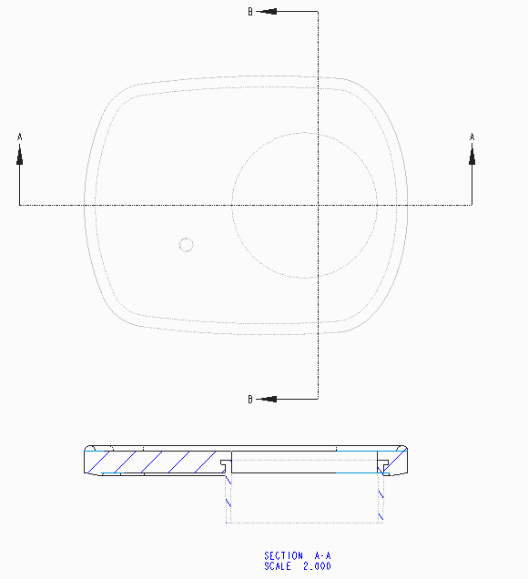

see attached data created in CR2.
  • xd.drw has 2 models assigned ... xa.asm and x1.prt
  • there are 2 views created ... one for xa.asm and one for x1.prt
  • views overlap ... using origin coordinates for placing coordinate system

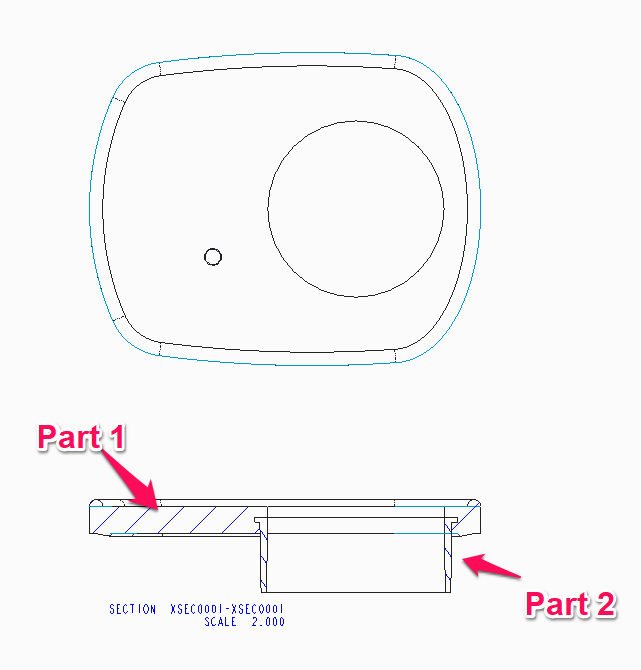

Would it work to show a view from the underside? Then that part would be visible, but you will "hide" part of the other part "beneath" the part now shown if you do not use hidden lines.
ArekTRI
(To:Dale_Rosema)
Hi @Dale_Rosema
those parts are moulded in.
Arek

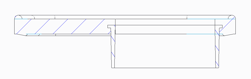

Go to the layout tab, select component display, in the view you want to show the part in, select the part, then OK in the menu, then select phantom opaque, then done.
ArekTRI
(To:StephenW)
Hi @StephenW
Thank you for another method.
Unfortunately, it is not working.
My steps:
Layout Tab
Component Display
Menu Manager - Style - Picked View
Select component of assembly - Selected from the Model Tree
Menu Manager - Phantom Opaque
OK
the result:
Martin Hanák
ArekTRI
(To:MartinHanak)
Hi @MartinHanak
thank you very much for the help.
Arek
