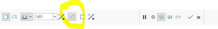

Dale_Rosema
(To:mn1)
Just do a normal extrude, but choose the Cut.PNG Icon to remove the material.
You can save it in the part but have it suppressed.
Or do a Save-As like the suggestion.
mn1
(To:Dale_Rosema)
Where fo I find this symbol?
Dale_Rosema
(To:mn1)
Start an extrude. It is in the main tool bar.
With assemblies, you can only do an extrude cut (you cannot add material in assemblies).
mn1
(To:Dale_Rosema)
Now i found everything. Thanks for help.
