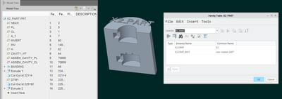

I have a need to use the name of a part in a family table, specifically in a cell of a "Reference Model" column.  The name needs to be from an instance of the part derived from this same family table.  The kicker is, family table editor allows adding the name BUT IT DOES NOT UPDATE if the instance is renamed.   The generic name at the top of the column updates as expected.  Below are the steps used to initial get the instance name into the cell.  Is there another way?  I've tried setting a parameter equal to the instance's part or assembly name and inserting the parameter in the family table cell.  This does not work, even though the value of the parameter updated correctly the family table apparently does not read the parameters value only the text of the parameters name.  Tried using PTC's parameter names for parts, assemblies and common names to no avail.  F.Y.I. I know this "Reference Model" column points to an assembly, the assembly instance needing to be referenced and the part instance in question will always have the same name.
This updates the assemblies instance name in the parts family table cell but if the assembly instance is renamed the cell in the family table does not update.
Thanks in advance

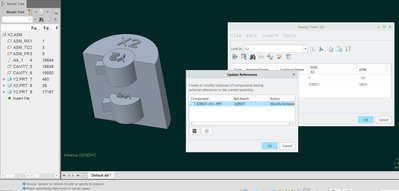

Hello @MT_WashPA
Please consider first that usage of Switch External References to Instances capability CREATES (and DOES NOTUPDATE) the Family Tree of Affected Component whose instance name was changed.
The components which have external references will be listed and those references will be proposed as new instances.
  • And this is therefore probably something you don't want
Then, please consider that this buisness need:
  • Is fully covered and supported in the scope of PLM systems, like Windchill:
    • This is due to the fact that PLM Systems ensure "Dependency Tracing" when doing things in Creo (Save as, Rename, etc ...)
    • This is illustrated in the little first demo attached with your files while Interacting with Windchill PDMLink 112.1
  • But is unfortunately not supported in standalone environments of Creo Parametric:
    • This is due to the fact that there is no notion of "Dependency Tracing" for things happening in Windows
    • Hence the reason why:
      • if a name changes in the structure of x2.prt (containing definition of the part family table)
      • It cannot be propagated AUTOMATICALLY to the structure of x2.asm file (containing definition of the assembly family table calling part instance)
    • Current limitation in standalone sessions is officially documented in article 63735 (behavior changed a bit in latest Creo versions, but limitation remains effective due to cause persisting and summarized above)
    • PTC provides a tool to do the required replacements in Assembly Family Table using the capability >Tools >Reconfigure Assembly Components >Replace with Family Table Instance
    • This capability is illustrated in second attached movie
Hope this helps to have a better understanding of what happens behind the scene, and how to proceed from now on to ensure semi-automatic (semi, because requires anyway manual actions) maintenance of Assembly Family Tables in the scope of Creo Parametric Standalone Sessions.

Second issue is related to renaming objects.  And you addressed what happens when parts are renamed, and I think that you demonstrated how the assembly family table will be updated even when not in session - when using Windchill.  But this is about renaming the instances of the parent assembly.
Because when is done, the ref.model column in the family table of the constituent part is not updated with the new name of the ref. model assembly.
Another bug is that "Switch External References to Instances" for some reason fails to create the required family table with the ref. model column.
But it sure seems to me that the "Switch External References to Instances" function works on my Creo 4 system to update the parts family table.
Hopefully these screenshots demonstrate the strange behaviours:
1) Models from PTC_help.7z provided by OP were modified to create this state:
Assembly X2.asm and its family table:
x2_part.prt family table:
x2 part genericx2 part generic
Note old style cut-out is at the bottom of the part and new style boolean cut is at the top of it.

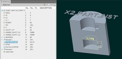

x2_part_inst.prt in the assembly instance x2inst.asm:
Assembly x2inst - note part instance x2_part_inst does not have the cutouts in the right orientationAssembly x2inst - note part instance x2_part_inst does not have the cutouts in the right orientation
Note neither cutout in the X2_part_inst.prt follows the actual placement of component Y2.prt...
2) After using the "Switch External References to Instances" function in X2.ASM family table:
Note ref.model column specifying the assembly instance has been added to the x2_part.prt
Looking at the x2_part_inst reveals something strange:
Assembly instance x2inst - note part instance x2_part_inst does not have the old style cutout in the correct orientation...Assembly instance x2inst - note part instance x2_part_inst does not have the old style cutout in the correct orientation...
(that is kind of weird - the old-style cutout does not follow the placement of Y2.prt)

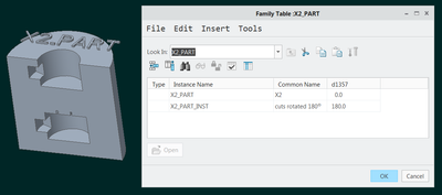

3) Let's delete the ext. ref column in X2_PART family table and add the column that drives the orientation of the plane ASSEM_CAVITY_PL (feature 9) and see what happens:
(that is also weird - both style cutouts work now...)
Actually, that's not right.  Closing everything, erasing memory and reopening the model shows the original problem:
Old style cutout works, new style cutout does not...
Well, I think having that 180° angle being switched both in the assembly and in the part has something to do with this confusion, but anyway...
4) Let's use the "Switch References to Instances" to add the ext. ref column to the x2_part in order to "fix" the issue:
It worked...
However, if I open the original data set from PTC_help.7z, delete the ext.ref column from X2.prt family table, regenerate and save everything and then reopen the files, I'll arrive in this situation:
Now trying to fix this by adding the ext.ref column via "Switch References to Instances" does not work:
X2.prt family table is unchanged and I have this error message:
Anyway, that demonstrates the strangeness of the behaviour of the cutouts in Creo.
Lastly, we can manually add the ext.ref column to the x2.prt family table and it all works again:
However, now if I rename the instance X2INST.ASM, then the family table of X2.PRT will not update:
(that needs to say X2INST-A)
Okay, then if I open the family table of X2.ASM and use "Switch References to Instances":
then the family table of X2.prt is updated:
