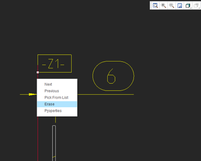

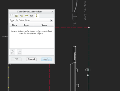

As the title said, I can't find datum after erase, how to let the datum appear again after erase?
this problem bothers me a lot 😭
Erased items are shown in Drawing Tree under the view node they have been originally shown. So, while in Annotate tab, in Drawing View expand a view node, then Datums node and the datum you have erased will be shown there as hidden (with greyed-out icon).

It's Working!! Thanks for your reply 😁
