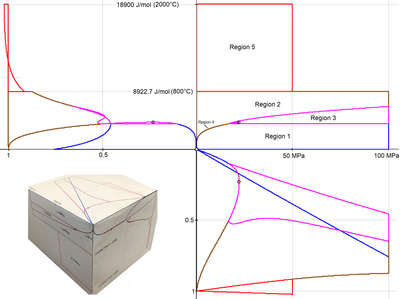

I need 3D diagram for Water and Steam
ValeryOchkov
I have three 2D-plots and 3D-Paper Diagram (hand made).
See more information in attach
Can you help me - create in Creo 3D-object!

Since you have the 2D plots at scale, have you considered using trace sketch functionality to apply the traces to the faces of a cube? Once you have the traces on the planes you can then intersect the curves in space to create the bounds for the regions within the cube.
http://support.ptc.com/help/creo/creo_pma/usascii/index.html#page/fundamentals%2Ffundamentals%2Ffund_four_sub%2FAbout_Trace_Sketch.html%23wwconnect_header

Can you create for me this cube? please? I have not Creo!
