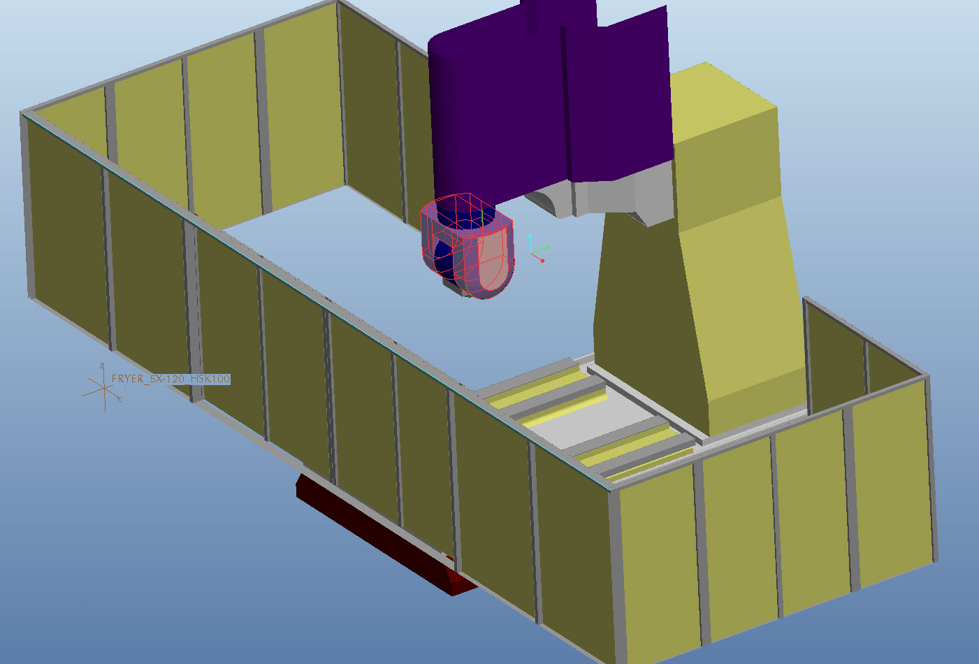

I imported a STEP assembly file. After the file loaded my model tree consisted of hundreds of parts. Each part is a surface. I was hoping/trying to combine some surfaces and solidify and export some solids (STL). I cannot combine or solidify anything, everything I want to do is grayed out (Merge, Solidify)
Suggestions?

You want to look at each part file you want and see if you can heal them.
it sounds like you got a really poor export. You might ask the provider for a better export attempt. The original files should be solids created in the native software, and not something that came from an IGES or other import/export.
Hello!
Try to import the stp file as 1 individual part and not as an assembly.
If you Edit definition of your imported feature the IDD will try to close the boundaries. If not combine all superficies and IDD will separate the ones that are in solid after u do ok.
This helped somewhat as I am now able to combine surfaces. I'm still having trouble turning those into solids, but I'm one step closer, thanks.
Did you try to make a shrinkwrap of the imported STEP-file? If you only need one part, this can sometimes be close enough to what you need.

Per your suggestion I did geometry checks. Some problems were found and one of the suggestions was to to tighten the accuracy. I did tighten the accuracy, now geometry checks is grayed out. Still can't solidify anything, if I go into IDD I can combine. I can do geometry checks in IDD, no problems are found.
The highlighted area is what I am trying to solidify and export as an STL
