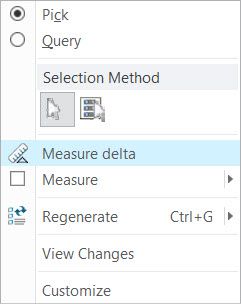

The below mapkeys create a macro for using the incremental measure functionality. If it is something you use often this is worth automating. I have added this to the UI customization available in Creo 4. It works in part mode and assembly mode.
The mapkey "imdi" calls the measure tool and defines a projection reference using a csys of the current model.

should the three different mapkeys be joined in one? What mapkey is used for the (RMB) "measure delta"?

Mapkey imdi is used and is placed in the UI to access using RMB menu. You have to add this new mapkey to the UI where you want to access it.
The mapkey imdi is a nested mapkey and calls .fcsx and imm. You only need to invoke imdi to activate the measure tool. You need to have all 3 mapkeys in session in order for imdi to function preoperly.
