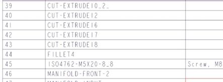

  1. How to excude out assembly level features in the BOM?
  3. Sometimes supplier's 3D model is an assembly, so i only need top assembly to show in the BOM, how to excude out it's subpart and subassembly items in the BOM? (In solidworks i can simplely check not show in BOM)
  4. When you have big assembly file, you group your parts into subassembly file, so i don't care this subassembly in the BOM, all i need is all the parts and subassembly in it. (In Solidworks, i just simplely promote everything in that assemble file then only shows parts in side.)
  5. How to export above adjusted BOM into excel? and how to do that without create a drawing? (Solidworks can build BOM table straight in modelling interface)

1.] I have never seen assembly BOM containing assembly features

You can add feature ad assembly level, that's why i got line 39-44
I know how to create assembly feature ... but I have never seen assembly BOM containing assembly features.

Are these entries actually assembly cut features?
Often when I import supplier STEP files and the like into Creo the parts in an assembly are named after whatever was the last feature used to create the part. I.e. FILLET37, or EXTRUDE_99.
Could it be that these odd entries in your Bill of Materials table are actually strangely named parts in an assembly?
The type of assemblies I see this in a lot are those generated by automated model creation software.

I think i found the solution for #2 and #3
set new parameter: BOM_DISPLAY, then filter out by BOM_DISPLAY = yes to control which to show which not show.
The only drawback is i have to add this to every part manually.

Just to follow up on What @MartinHanak said you can filter on name as well:
Table Tab -> Repeat Region -> Filters -> Pick BOM Table -> Edit
Then put add the line below or customize it as needed
&asm.mbr.name != *CUT-EXTRUDE*
