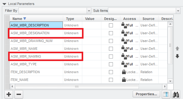

I am sending modified drawing. It contains following repeat reqion.
The most important change was made in Local Parameters section of Relations dialog box. I added two parameters - see red rectangle.
I clicked OK button and the Relations command again. Now new parameters were displayed as shown below.
So ... basic rule, which must be fulfiled is ... every parameter mentioned in relations must be present in Local Parameters section. Unfortunatelly parameters, which are not displayed in repeat region cells must be added manually.

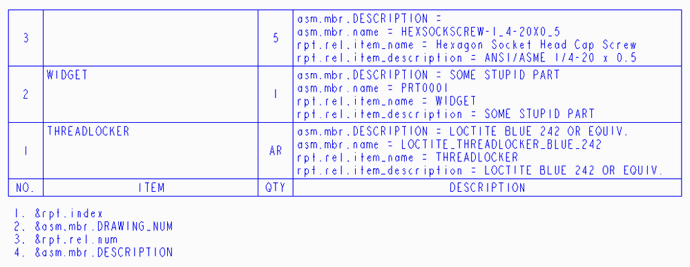

Here is my repeat region:
And the result:
You could make things easier and make the columns wide enough to read the contents so the entries don't overlap.
Anyway, I recall that using underscores is something to be avoided for repeat region relations. Feel free to shorten the names to IN and ID, at least for a trial.
Underscores are indeed a problem if you are working in Repeat Region Relations(*)

So, trying "ID" and "IN" instead didn't work.
I tried hamster's method and it worked using "my_name". So the underscore works in that string parameter.

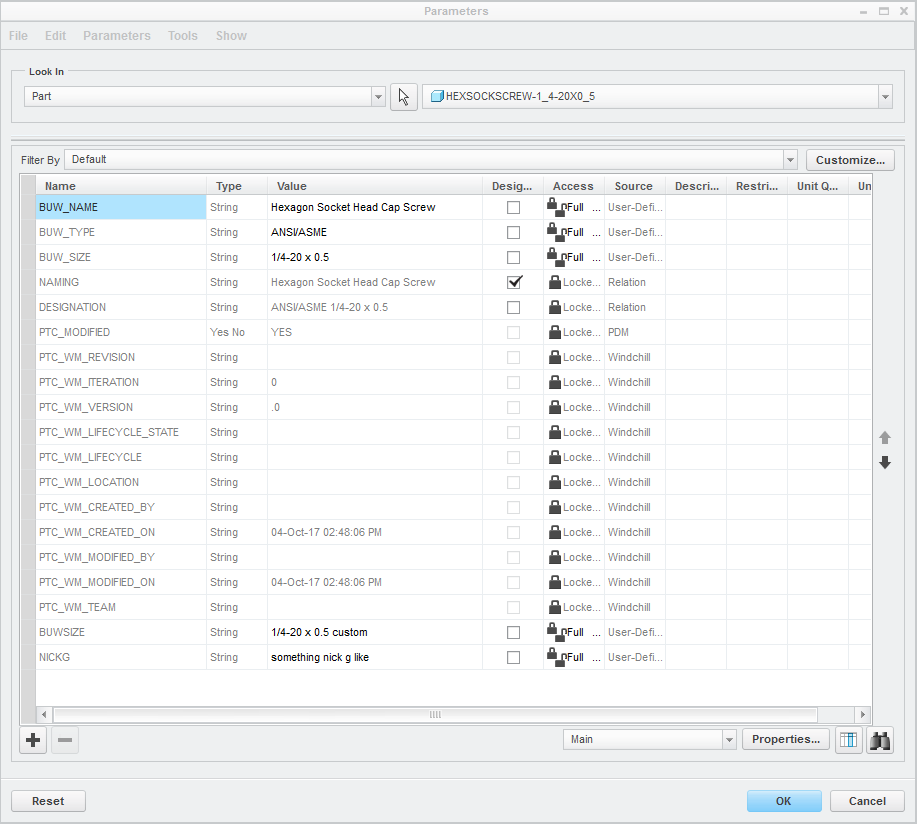

So now the table will show the description for my created parts, but is blank for the screw file. I've tried several of the parameters listed, as well as making my own parameters (BUWSIZE and NICKG). I can't get anything other than "asm_mbr_name" to display in my table. Here is the parameters shown on the hardware:

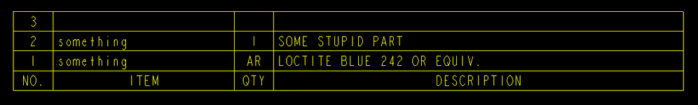

Great idea! Here's what I wrote (I commented out one of the sections):
item_name="something"
item_description="something2"
/*if exists("asm_mbr_naming")
/*item_name=asm_mbr_naming
/*else
/*item_name=asm_mbr_drawing_num
/*endif
if exists("asm_mbr_designation")
item_description=asm_mbr_designation
else
item_description=asm_mbr_description
endif
The end result is that the two parts I made take the set value, but the screws won't. I'm wondering if this is because we only have the free (included) version of the intelligent fasteners, and we need to pay for the full package in order to rename them.
I meant, are they in the list of parameters in the repeat relations dialog. It doesn't matter if they are in the parts. It also doesn't matter about the licensing - you aren't changing values in the parts; you are creating new parameters in the repeat region.
See how you had asm_mbr_type under LOCAL PARAMETERS? That same thing needs to happen for the other items.

I was looking at the same thing Doug is. The hardware parameters are not being transferred to your drawing for some reason. I tried designating the parameters in the partfile but that did not help.

The only two missing were "naming" and "designation", so I added those but it still did not work.
However, I don't think these are necessary. The other parameters (drawing_num, description) aren't listed in the parameters, but my relations still pull that information from the part files. I think the only parameter that needs to be listed are the parameters created as a result of the relation (item_name, item_description).

I also notice that 'designation' parameter is listed as being the result of a relation in the fastener file, which means that you can use the User-Defined input parameters to recreate that same result in the repeat region relations. I don't know why you would have to - generally it only takes me a short time to debug a repeat region, but then I can see all the pieces at the same time.

This is great, thank you! I had tried adding the parameters "naming" and "desgination", but they needed the "asm_mbr" prefix before them to work.
I then changed the repeat regions to "item_name" and "item_description", and added relations to change the value of the name (i.e. from "Hexagon Socket Head Cap Screw" to "SCREW, SHCS") and I've got a very functional screw tool that works with our BOM.

repeat region relations are not correct. You cannot use if exists("naming") !
You have to:
  1. add ASM_MBR_NAMING parameter in Local Parameters area in Relations dialog box
  2. use if exists("ASM_MBR_NAMING") command
