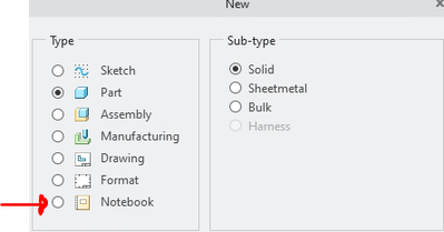

Hello @MK_9183946 . If you want parameters to be called whenever you want them  , use NOTEBOOK in creo to store parameters. They become global which can be accessed whenever needed.
