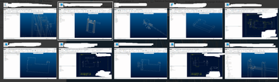

I am on Creo 4.0 and when I hold the Ctrl key down and then start tabbing, I can see all of the different model and drawing windows. Does this go away in a later release of Creo?
That's interesting, it definitely doesn't do anything in Creo 7.0.5.0. I'm not sure why that feature would be removed.
Dale_Rosema
(To:seanmm18)
That's with Ctrl + Tab? I can see different open windows when I use Alt + Tab, but it looks like it's a Windows feature rather than Creo and it pulls up every open window, not just Creo.
Dale_Rosema
(To:seanmm18)
You are correct -  Alt-tab. Brain warp late in an afternoon.
Yes it is a Windows thing and pulls everything up.
It is fairly quick to switch that way.
I had several other things open also, I just had the most recent as those windows in order to get the screen shot.
