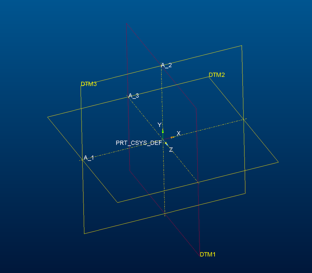

On entirely other subject:  how can I display datum planes as in earlier Creo versions in where one side of the datum is yellow and the opposite side is red ?
tbraxton
(To:ptc-2373)
Understood on the layer controls.
Is this what you are seeking for the datum display? If so, start a new thread and I will post the method to get this in Creo 8.
Involute Development, LLC
Consulting Engineers
Yes, that is what I want. I did find the config.pro setting for  it:
set enable_legacy_datum_planes yes in config.pro
So no need to pursue any longer.
Thanks for the help
