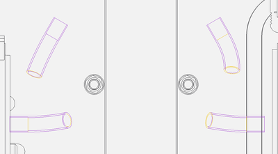

I have a problem with Assembly drawings in CREO 10.0. Some lines/edges of parts that have been imported as STEP models show up in an assembly drawing even when behind other parts.
These tubes are heat shrink wraps on cable behind several other parts and...
These are connectors also displaying through several other parts in the assembly.

The magenta lines are surfaces that didn't convert to solid during your import. Sometimes you can fix those, but with those threaded areas, it may be a lot of trouble.

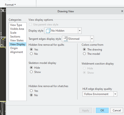

You can turn on hidden line removal in your drawing for HLR using the config.pro option hlr_for_quilts yes
Check your drawing view properties, it should show hidden line removal for quilts is set to yes
If your view is a cross section view, you will also need to edit your cross section to "include quilts".
