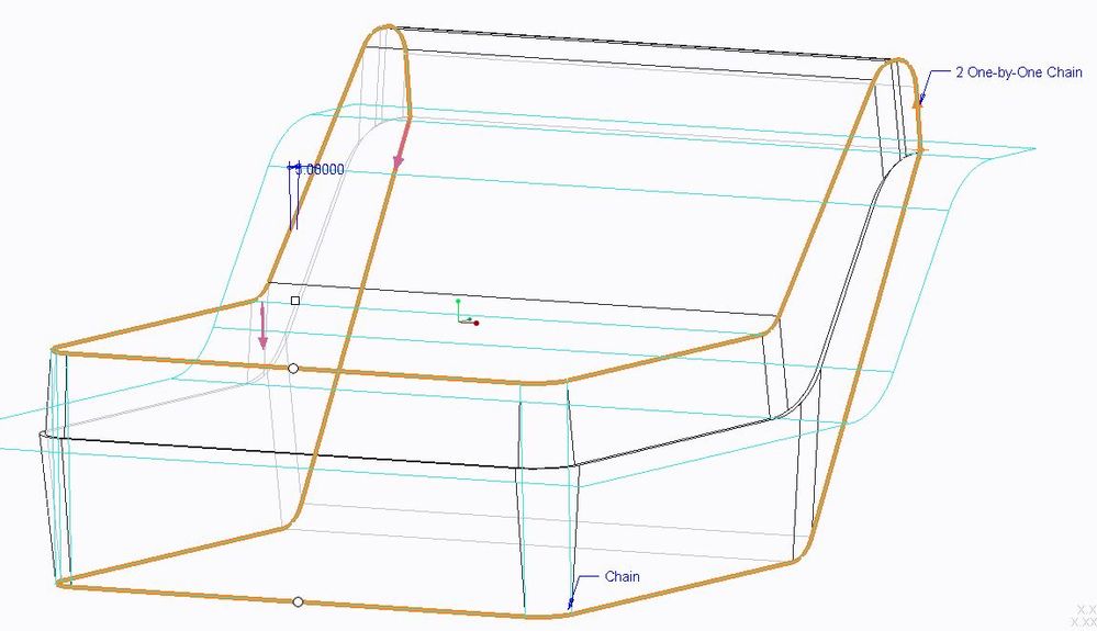

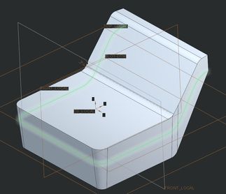

What I from time to time need is to be able to draft 2 sides dependently but carry at least the minimum draft value to both sides.  The problem is that many times the thickness from the depth from the parting line along a part might favor the top side as well as favoring the bottom side.
There is a hinge in both the top and bottom, and the draft has to be additive.

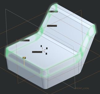

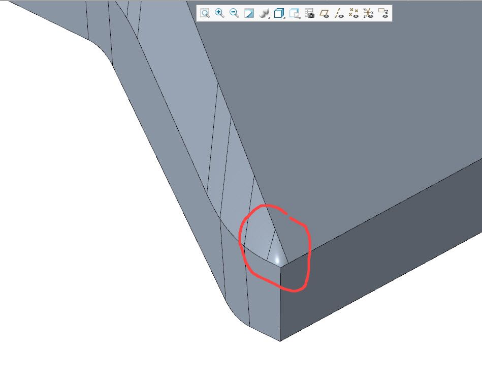

If you draft each side independently there will be an overbite noticeable.bottom dominant.JPG
If you look near the red lines you can see that by drafting independently the overbite is on the bottom impression in the above picture.

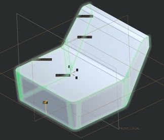

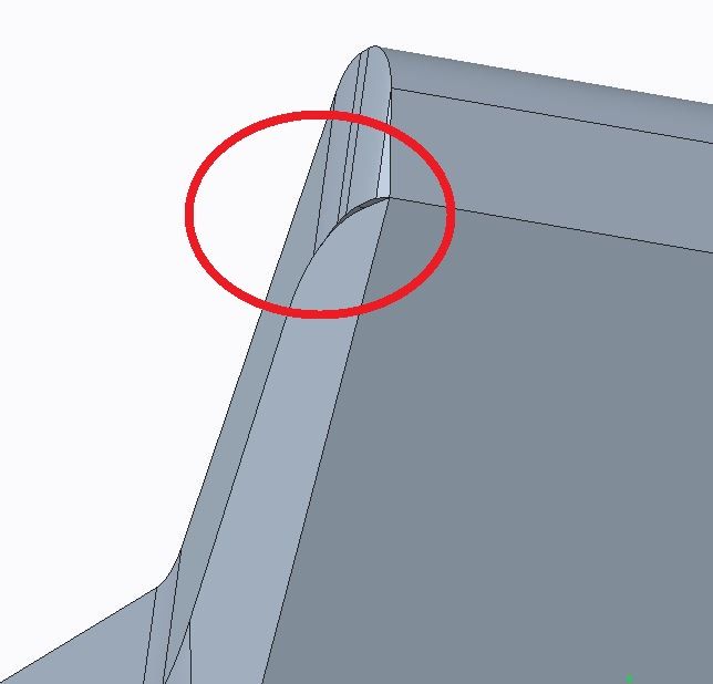

Looking to the next picture however you can see in the red circled region that the overbite is on the top side.top dominant.JPG
What I need to do is match draft to where a minimum value of 5 degrees is held on both sides.
If I draft these sides dependently I could either favor the middle picture side or the bottom picture side.  The problem is that one side will be exactly 5 degrees while the other will have a region or regions less than 5 degrees.
In our line of work we have to have a minimum of 5 degree draft in order to achieve separation from the dies.
If there is no solution for this I imagine that I could draft both sides 5 degrees, build a sketch with the outermost draft extent from each side taken to the parting lock split.  Then I would need to generate an intersection to the parting face with that sketch.  After this I could build a swept blend or independent ruled surfaces that join at the parting lock.
This certainly is possible but a lot of extra work.

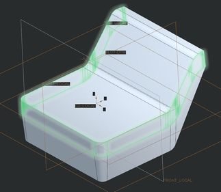

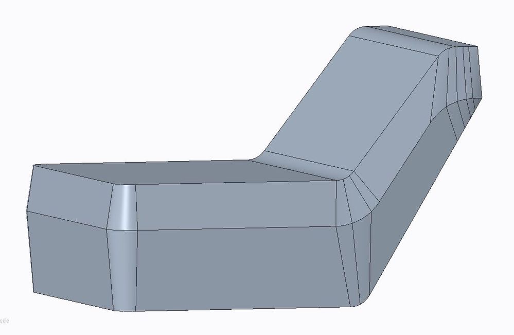

Just FYI I will show you what I end up with by combining 2 boundary blends (which were solidified out of the original shape).
In our line of work this would be a typical application of match draft.  Where you hold the top and bottom lines in the die and you have to adjust draft to meet at the parting line.

What I am trying to do is hold the hinge curves (see 1st picture in my post) and have at least 5 degrees draft where each side meets the parting lock.

Without seeing your models, the truth does appear that you can't hold top and bottom while matching at the parting line and guaranteeing 5 degree minimum draft.  There may be times when going to the largest extent at the parting split and just doing a simple 5 degree draft back in both directions would be allowable.  I chose the route that takes longer, but does meet the requirements.that I'm looking for.
I would love to see the software have a true match draft command.

(To:dgschaefer)
Doug,
The only thing that doesn't work with your method is that the top draft has a small region on the right side that would undercut.  I do like your method.  It would be simpler than my work around.  It is good to have someone look at alternative solutions.
If only true match draft were an option with Creo.  It almost pulls it off with their dependent draft option.  If you choose the bottom hinge as dominant you can match the hinge from the top side.  Only thing is that in the same area as your method undercuts the dependent draft ends up too small.

I am starting out with a rectangular box prior to the draft that gets applied.  My intention is to have a perfect match to the edge I've shown in the 1st picture as the draft hinge.  I don't want to use up any of my tolerance inside or outside of the draft hinge.  That beginning rectangle is the size we are being held to.
