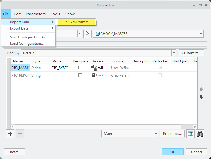

hello,
I'm trying to create a mapkey that would create about 10 parameters for old prt files.
However, if one parameter even exist, mapkey stop.
Anyway to continue for others parameters?

For 10 parameters, import a file. I would import a parameter file using .xml file to add the parameters to the model. You can still use a mapkey but try importing the file and see if that works to overwrite any existing parameters. I have not tested this, YMMV.

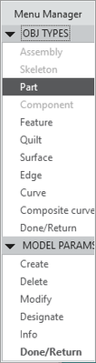

if you add hidden option NEW_PARAMETER_UI no into config.pro, then Creo will use following old style menu for managing parameters. This enables you to create mapkey you need.

Hi everybody,
I tested NEW_PARAMETER_UI no now in creo8 and it doesn't work any more... 😞

@Trebla wrote:
Hi everybody,
Article
Works for me in Creo Parametric 9.0.5.0
