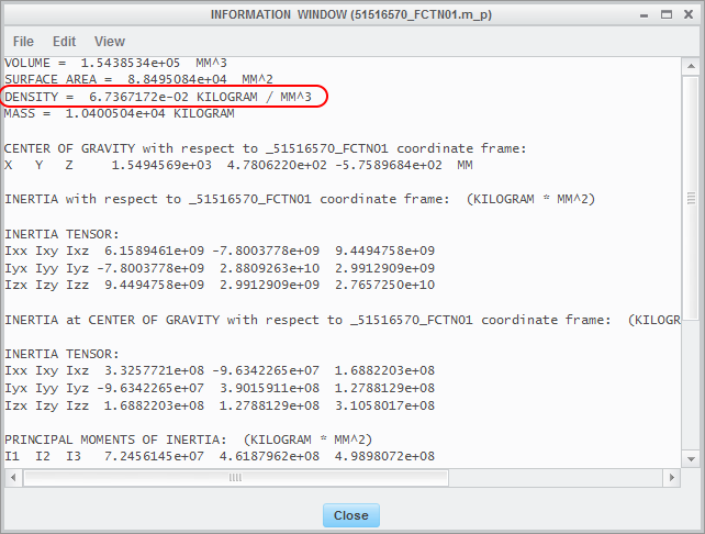

A colleague is struggling to make some parts report the correct mass. This appears to be because, no matter what settings or parameters we change, the mass properties report ignores the material density, or an assigned density, and continues to use a value of around 0.067 kg/mm^3 (which, for those of you not familiar with that unit set, means that our 2 foot long bit of ~5/8" pipe has a mass of around 10 ton(ne)s).
We've tried using Define Properties by 'Geometry and Density' as well as 'Geometry and Parameters', and setting the density value in that window, by assigning a material, and by changing the parameters MP_DENSITY and PRO_MP_DENSITY directly. Nothing seems to take effect.
The part was originally created by a client, and they have some macros to assign material properties - this may or may not be relevant.
Any clues, please?

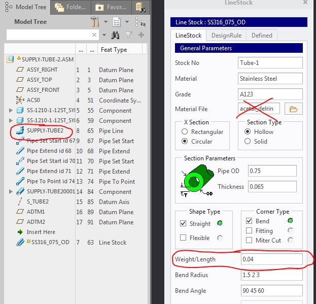

You mention that your pipe weights around 10 tons. Was it created using piping? If so, then it ignores the material properties set this way and instead uses the weight/length in the Line Stock when you redefine it.Capture.JPG
BTW, watch the units that you might get from suppliers, they might be Kg/meter but remember your model units.

Thanks, it was indeed created using Piping and my colleague reports that using the weight/length parameter has fixed it.
Much appreciated - I haven't used Piping so wasn't aware of that quirk.
