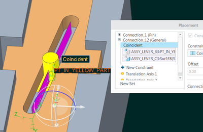

Well, I'm not sure how realistic your analysis needs to be, so:

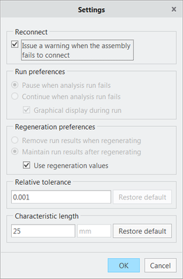

-3D contacts is probably what you want to do if you want more realistic simulation, including "dead zone" However, as you found, it's easy for the 3D contacts to lose their connections.  Maybe try changing the mechanism accuracy settings?

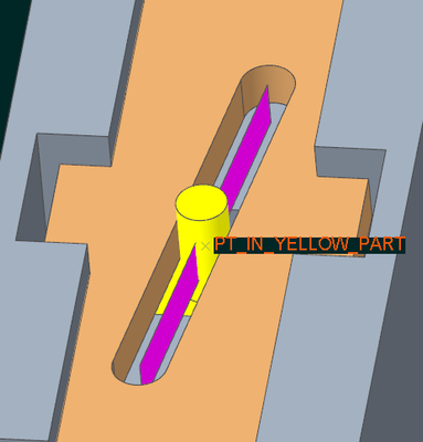

Also, maybe rounding the edges of the slot?  I find it produces smoother motion (full round works best).  If I don't swing that lever around too fast, it stays connected:
Lastly, if you are only looking for roughly descriptive motion, then I think general connection could work here.
For example, I made a point on the lever part and the purple surface on the sliding plate slot part:
Then in the assembly:
(connection made in the lever part.  1st connection is the pin that constraints its rotation within the housing.  2nd connection is the general type, which makes the yellow point be coincident on the purple surface.
