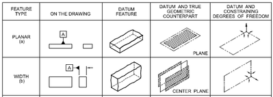

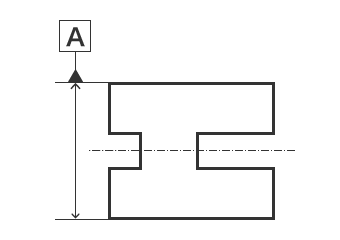

Creo used to have what were called "set datums" which attached to datum plane features. Starting with Creo 4 they did away with these for MBD. It is not good practice to attach a Datum Feature Symbol to a datum plane because it begs the question what are the features that define that Datum Feature Symbol. If you have a dimension that defines the midplane then to attach the Datum Feature Symbol to that as shown below.
It is also possible to "cheat" although I don't recommend this. If you create a small fill surface on a datum then you can then attach a Datum Feature Symbol to that fill surface.
TomU
(To:DARYLREECE)
If the datum feature symbol is attached to the feature's dimension, then by definition the midplane of that feature is the datum.  It's not correct to attach datum feature symbols to datum planes.  Even though these planes are 'features' in the CAD software, they are not features in real life since you can't physically touch them on the actual part.  Datum features symbols are only supposed to be attached to actual features - something you can physically touch on the part.
Edit:  Good explanation of this here:  https://www.gdandtbasics.com/relating-secondary-datum-feature-to-primary-datums/
