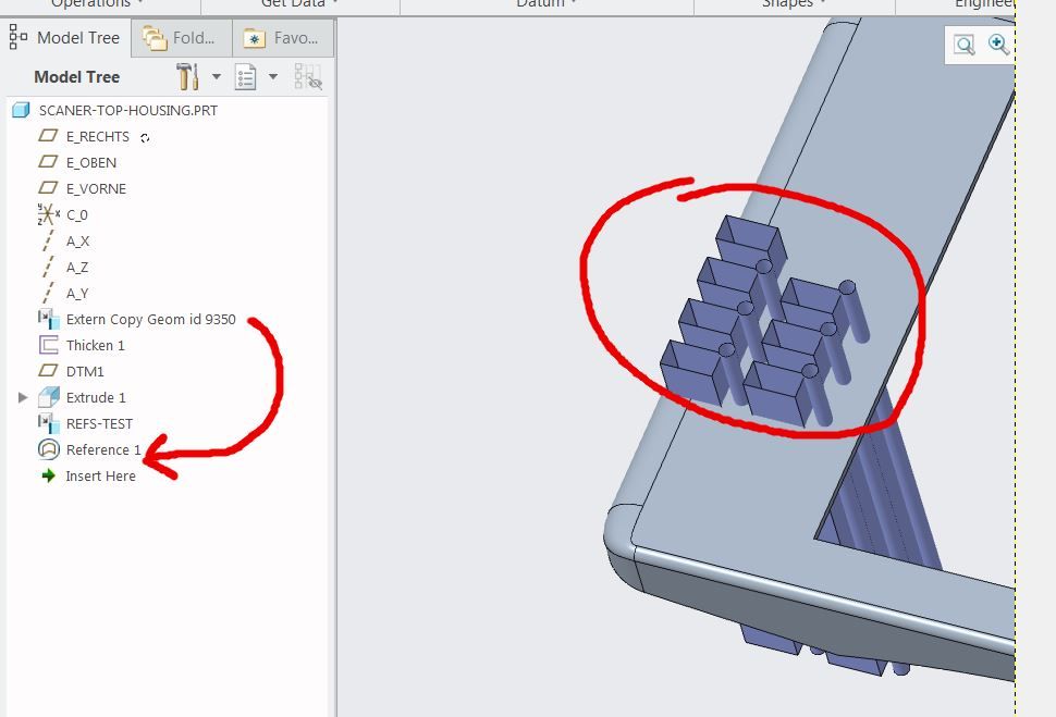

Hello guys
there is a topic I am playing with related to taking automatically all quilts from Copy Geom feature into Solidify tool and remove material according to them.
Common approach is following: one has to select each single quilt for seperate Solidify tools
This produces a lot of steps and problems with regeneration while some quilts after changes in master model are misisng in Copy geom.
So I thought : would it be nice to collect all interesting to me quilts in one place and then use them with only one Solidify tool. Copy tool does not allow this
Has anyone of you played with such problem before?
I tried following:
1) collect all quilts together in Datum Reference > Intent Surface (still I can not force it to make it automatically all the time)
2) fool the Copy tool by pushing it to collect quitls by Filter > Intent Surface, but it does not work 😞

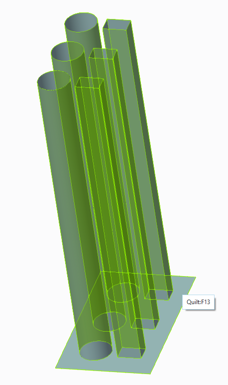

TomU
(To:Jacek_Mydlikows)
@Jacek_Mydlikows,
One method I've used in the past is to combine all the related quilts in the master model into a single quilt.  That one single quilt (with multiple "pieces) will only take a single solidify feature to cut all the holes in the parts it's copied into.  (It doesn't hurt anything if some of the quilts are off in space, outside of the model.)  With this approach, any future changes are just make to the the master model and all the children automatically update.  Of course it becomes much more difficult if one of the children parts needs to exclude certain holes since there is only one copied quilt making all of them.
