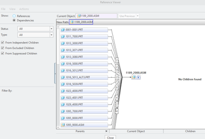

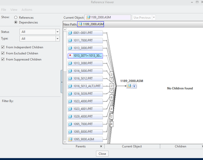

Try looking at the reference viewer. Sometimes it shows broken links or missing information that you can't find elsewhere.
Before or after "recreating" the missing instance.
Good question.
I would have to say try whichever you have open first and see if it shows anything. Then try the other.
I would expect it show better without.
This is before I recreated the missing instance.

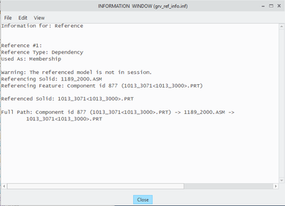

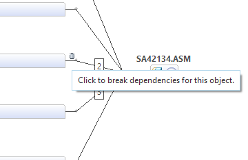

RMB on the dotted line there and select INFO and see if you get any clues
It looks like it is being used as a reference, but I am not sure how?
Maybe try with the instance re-created. Maybe it will give you a clue...maybe??!?!
Does it look like there is some sort of circular reference?
Comp id 877 (1013_3071.prt) -> 1189_2000.asm -> 1013_3071.prt

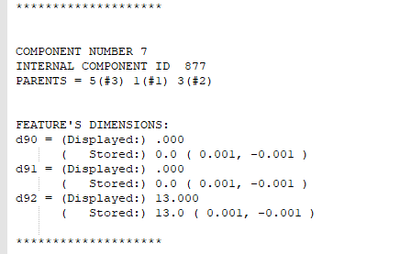

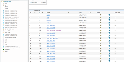

Looks like it is Feat ID 877 in the assembly.

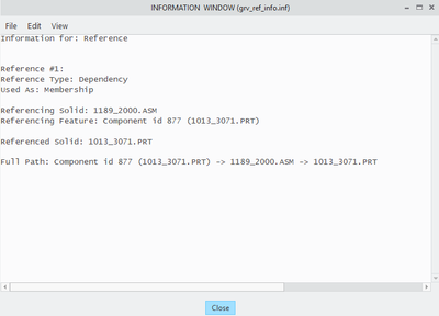

May be the result of replacing a part with "Remember These Components" checked. What does the reference look like when instance is restored? I there a trash can to remove it.
It has changed the dotted line to a solid line. Where might I find that trash can?

In the assembly model info, Look in the feature list for ID 877. This will show you feature No. to help you find its location in the tree.
It is in the feature list, but not in the tree:

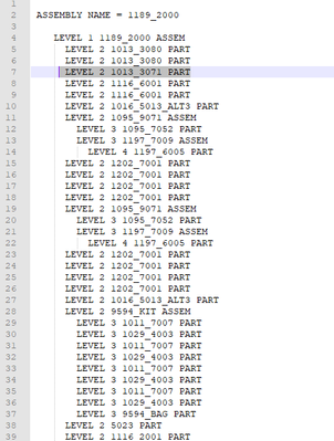

I deleted 1189_2000.inf and recreated it. This is also with the instance temporarily back in the 1013_3000 family.
Full path with the "instance not added to the table"

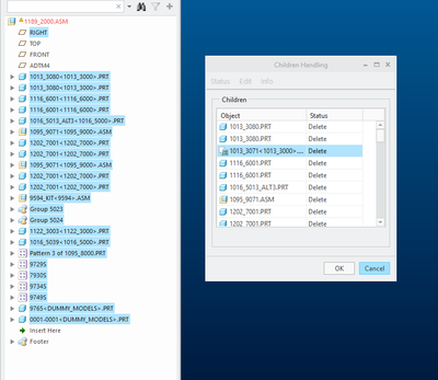

Tried something unique: I highlighted datum plane "Right" to delete from the tree. This what showed up:
I did not follow through on this, but is there is a way to get the 1013_3071 highlighted for deletion without trying this.
Hi, wondering if you "followed through" on that trick which looks like a neat work-around.
I assume that hidden "suspend all" option is there, so shouldn't be too much clicking...
I renamed the file before trying this.
I decided to delete the front plane (lower in the tree and can be recreated from the right and top plane).
I suspended all of the items except the missing item.
After recreating the front plane, I was able to reattached any constraints that were looking for the front plane.
Every thing is now happy with the structure.
That's cool. Instead of deleting the top feature, could you simply suppress it? - because that should also trigger that "children handling" dialog box...
That's good to know for "next" time. 🙂
Do you have everything checked to show in the tree filter. It should be between 1013_380 and 1116_6011 judging by the No. in the feature list. Turn on the Feat # column in the tree to see where it should be.
Is it in one of the groups?
It is not in one of the groups nor in any of the subassemblies. I expanded everything all the way just to check.
