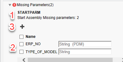

I've been using Modelcheck in Creo 5 for a few months now, as I configure our setup from Creo 4 and prepare for training and migration. I would like to provide feedback:
I provided some of the same feed with the Creo 5 Sneak Peak - see my video from back in January 2018.
https://community.ptc.com/t5/video/gallerypage/video-id/Q1NGh4ZDE6ucAval57YyTFn-8oSSNNKT
we really need, as a minimum, an option to expand all categories by default. Otherwise, I'm not sure we can move to Creo 5 without major pushback.
I probably agree with the icons as well. The old "Add" and "Update" buttons were more obvious that ModelCheck could help users add missing info than + sign and a pencil. Not near as much of a problem as the categories though.
Thanks for the feedback, gentlemen, and for your patience in awaiting a response. In order:

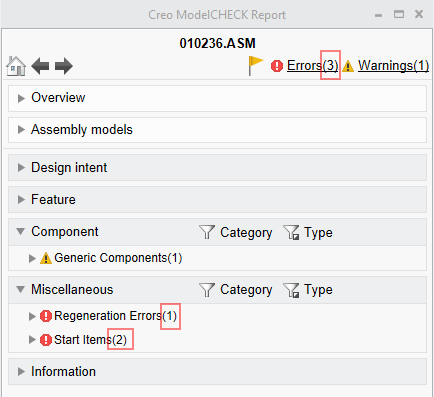

1. I agree with you: that's confusing. We're looking into ways to mitigate that confusion. Possibly reformatting how we display the numbers so that they aren't shown in the same way. Or perhaps having the top level numbers mean the same as the individual check numbers: the total number of errors and warnings found, rather than the total number of checks in which errors and warnings were found. Any preferences here?

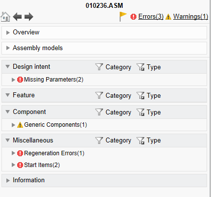

2. I'm not sure I understand the concern here. The groups are there to better organize the checks, so users can more quickly find a certain check if needed, especially if there are a large number of errors or warnings. But perhaps you're saying that that's not all that useful? That being said, we are wanting to implement functionality to allow customers to customize the groupings in the report. Won't be in Creo 6.0, but maybe Creo 7.0. Thoughts?
3. I agree with you on this one as well. However, the reason that the buttons are above the list of features/parameters/layers/etc. is for situations in which that list is long, in which a user might not realize that there is an action that can be taken. From your perspectives, would having the buttons at the bottom of the list be an acceptable change?

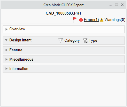

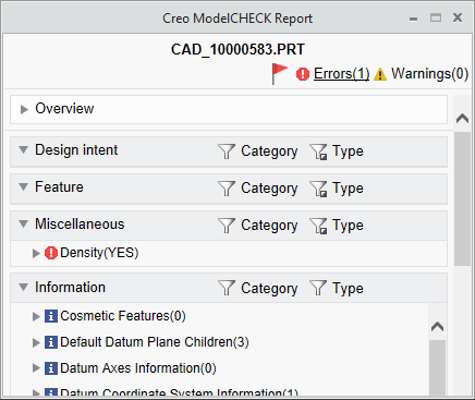

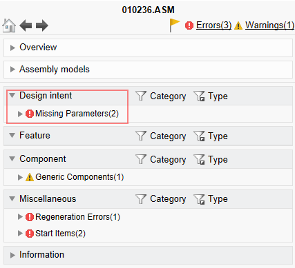

4. A few thoughts on this one: (a) You may already know this, but clicking the top Errors or Warnings link will expand all of the groups in which Errors or Warnings are found. (b) Currently, only Design Intent gets expanded by default. I don't really like this. I'd rather have all groups with errors/warnings expanded by default. The only potential problem here is that in cases in which there are many errors/warnings, seeing all of them would require users to scroll. Personally, I think that's fine, but I'd love to validate that. Thoughts? (c) There's a hidden config that you can use to show all of the errors/warnings in an "All" category. They are still listed in their respective groups, which means that technically they are listed twice in the report. But you may still find it useful. (MC_REPORT_SHOW_ALL_TAB YN)

1. If you want to differentiate between checks and errors, I would actually spell it out next to the numbers. For example the top would saw "Errors (1 Checks)". And next to Geometry Check, it would say "Geometry Check (4 Issues)". I am not against getting rid of the Check count all together, since the issue count is more important. It is also a little more meaningful with the Windchill parameters. However, we just need to be careful for some of the checks that list more issues than necessary. If it is one issue, it should only be flagged as one. I'm going to submit a ticket for a scenario where it comes in as issues for one error when using mc_regen.mcr, in preparation for this.
2. Customizeable groups will be great! This way we can match the groups to our company checklist groups.
3. I understand. My concern is that it isn't even noticeable that some of these are buttons. I would update the GUI to make it obvious it is a button and replace the icon with the actual task name, or include the icon with the name, like every other button in Creo (by default). If you really want to revamp the GUI :(, after a check is expanded, the information should be split vertically. The issues on the left with a nice obvious big task button to the right. As you scroll through the list, the task buttons do not scroll as well.
4. Hidden config - AWESOME! It is now part of the company standard. Now we can push out Creo 5 when ready :). In order for a user to scroll, they would have to have upwards of 20 errors and warnings, which (I should imagine) is highly unlikely. Rather, a typical user would see a handful of issues and would like to see them at once. Getting users to run modelcheck was a long and tedious journey that we are still very much a part of. Having users press extra buttons to see mistakes they made is not something anyone would want to do. As it is, we have an advanced mapkey that does so much more than modelcheck, which they use; just so that our users save as much time as they can. Otherwise they won't use it.

When you run ModelUPDATE, the Update group is at the top, above All, correct? So what happens is that whatever is the top node of this "tree" will be expanded by default. So if you run ModelUPDATE, that will be Update. But if you just have the All category (no Update), that will be at the top and so will expand by default. I don't think it has to do with whether there are only Warnings in the All category, but let me know if that's not accurate.
That would make sense. However, if there is nothing for the model to update, the group is not listed altogether (which is fine). In that case, nothing is expanded, not even ALL.

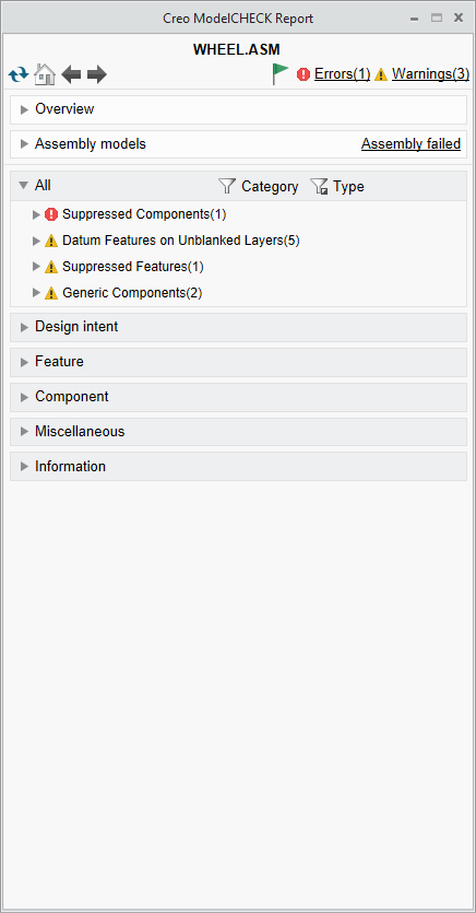

You have to add it into config_init.mc as below:
MC_REPORT_SHOW_ALL_TAB YN Y Y Y Y

I tried it, but it did not work as expected.
This is the report after mc run:
And that is, what I expected:
Did I missed something?
Hi Mat,
The only thing I can think of is that perhaps you need to close and re-open Creo in order for the config change to take effect. After I made the config change and then re-launched Creo, I see the following (which is not quite the same as what I think you were expecting. The config will not expand all categories by default but will instead add an "All" category that, if it's the first category, will be expanded.)
@lwestbrook wrote:..The config will not expand all categories by default but will instead add an "All" category that, if it's the first category, will be expanded...
That's it! Thanks!
