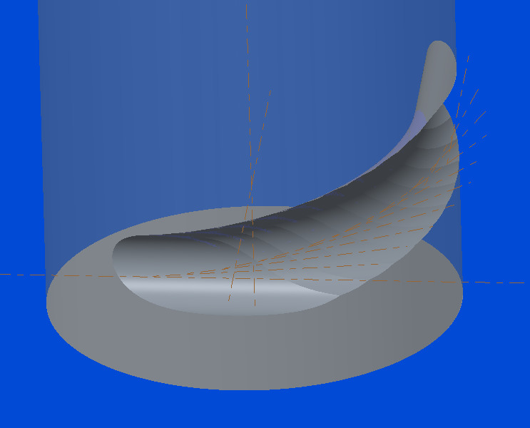

I've had some success in generating 2d sections for a sweep along a helix in Creo 3. So far I've tried a cylinder and wedge and compared the results of the surfaces generated by sweeping a 2d section and creating a boundary blend to the surfaces generated by patterning 3D cut along a helix.
Kevin
(To:StephenW)
Here are the the results if anyone is interested.
cylinder
wedge
rounded end

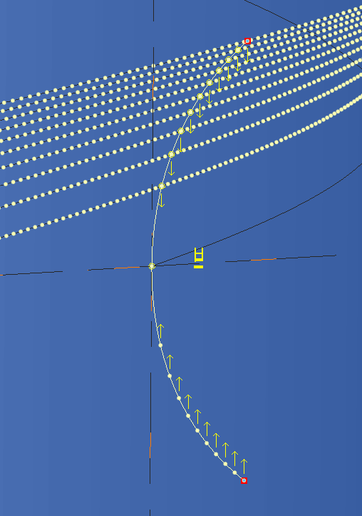

I started by creating bounding curves. Looking at the intersection of the cylinder with the shaft the cut is bounded by two helical curves created by wrapping curves onto the shaft surface. A curve was created by equation for the inner most curve which is used as the trajectory curve for a sweep. Surface contour curves are created by intersecting increments of the shaft diameter with the cylinder and helical curves are creating by wrapping curves on the shaft surface increments. The intersections of the curves created by intersecting the shaft and cylinder with the helical contour curves define points on the cut surface through which a curve through points can be created. The curves can be patterned along a helical path and a boundary blend can be created using the surface contour curves in one direction and the patterned curves in the other. For a sweep I defined points of intersection on the surface contour curves with a plane that passes through the axis of the shaft that define the sweep  profile. The inner most helix is used as the main trajectory curve and the surface contour curves are specified as additional trajectory curves. The sweep is defined with a normal direction specified along the axis. The profile curve is a spline through the intersection points with the trajectory curves. I created quarter pitch surfaces, copied them, patterned them four times, and merged them to create a full pitch surface. The full pitch surface was copied and patterned along the shaft axis, the surfaces were merged, and solidify was used to removed material for the cut.
The wedge was a little different in that the surface contour curves near the wedge inner edge pass through the edge of the intersection of the wedge with the shaft but are not tangent. As you move out the surface contour curves eventually become tangent to the intersection curves.

I actual made the cut using the three methods of boundary blend, sweep, and pattern of a solid cut. The surface for the cut along the entire length was created the same way for the boundary blend and sweep. I started by looking at the intersections of two horizontal cylinders with one rotated a few degrees to the other. The curve generated by intersecting surface intersection curves with the helix curves isn't planar so I used a boundary blend. The following images show the surface created (I just did the top portion of a cut segment to show the process):
Comparison of the boundary blend and pattern of cylindrical cuts:

For the sweep the points of intersection are are the helix curves where they intersect a plane that passes through the shaft axis. The sweep uses the inner curve as the main trajectory and the other helix curves as additional trajectories. Since the cylinder is normal to the shaft I made the section normal to projection. The section provides snap points to the helix curves for the top surface of the cut and the bottom is created by placing a construction axis and making the spline curve points symmetric.
Pattern surface and merge to get the following:
Pattern merged surfaces and merge again to get:
