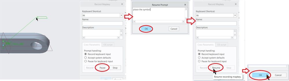

hi DTC60,
You could add a 'pause' in the mapkey when you are recording it. In this pause you will clic the mouse middle button twice, then resume the mapkey to be able to select "OK" in the dialog box, and finish the recording.
Every time you run the mapkey you have to click the mouse middle button twice 'manually' and then click resume, but the job will be done.
